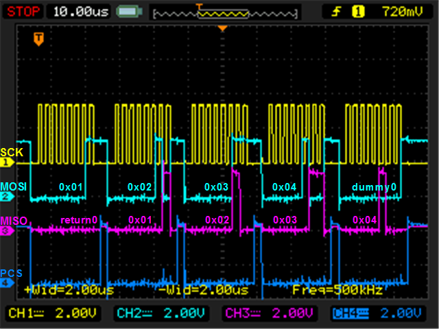

In order to reproduce the issue, I do the following:
1. Transfer data from mater to slave (when fifo are disabled) - print the data on the slave interrupt see that all data arrived ok.
2. in slave interrupt echo it back to the master
3. in master interrupt , print the data you get.
Observe the spi data by oscilloscope: I see that the first byte return is zero.(The slave has not fill the first received data into the fifo.) In order to get all the data I need to push additional one byte from the slave.(See the attached image "master send and receive slave echo.png")
"In my app , i need to parse the data in the slave , process it and then replay to the master, it is not an echo back up."
The master send a "data ready or not" command and mean while the master get the first zero.
The slave return "data ready or not" command and mean while the master get the status of  slave "data ready or not".
So in order to get four data after the data of slave has prepared, the master has to pushed two more bytes.(from the master total 6 bytes)

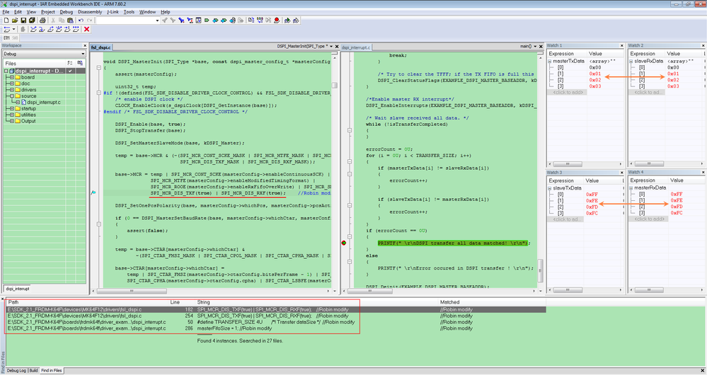

I am not sure if you are using the dspi interrupt example in SDK_2.1_MK64FX512xxx12.
After disable the fifo for both RX and TX and for master and slave(See Line 182 and 254), and modify other two place(See Line 50 and 286).
That example seems can run correct on my FRDM-K64F board.
