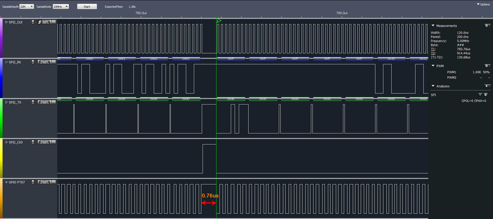

I use a logic probe to capture the actual SPI data and clock coming off the K64
Data on MOSI line is ====  0,1,3,4,5 ... 255
Notice byte three (3) of the input data (byte value 2) is eaten and never appears on the MOSI line out of the K64.

JHinkle
Senior Contributor I
Thanks for looking into this Mike
Below is a snap shot just before kicking off the SPI-DMA transfer.
You can see the SPI code in the editor window, the array of data to be transferred in the bottom memory window, and all the SPI1 registers just prior to starting the process
Here is the capture of that SPI transfer - notice that the output goes 0,1,3,4.
The third byte should be 2 but its 3
I've attached pictures of the DMA registers for your review.
I've also included the complete logic probe capture should you want to dig into it further.

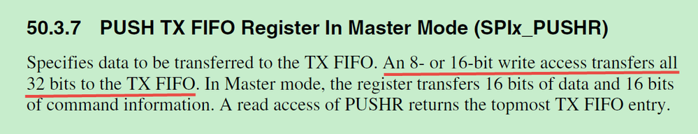

Hui_Ma
Please check below description about SPIx_PUSHR register write requirement:
When you are using DMA mode, it need to transfer all 32bits (command+8bit data) to this register at the same time.
Thank you for the attention.
