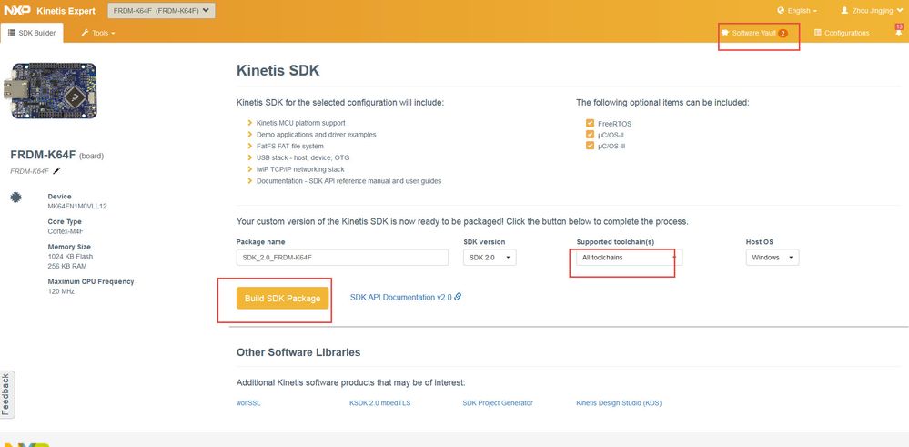

    Your problem is the SD initialize question.
    Now we already have the MDK KSDK fat code in our KSDK2.0, please go to this link:
Welcome to Kinetis Expert | Kinetis Expert
  Click build a ksdk and choose the FRDM-K64 board.
  After you download the sample code package,  you will find the project in folder:SDK_2.0_FRDM-K64F\boards\frdmk64f\driver_examples\sdcard_fatfs\mdk
Please try it on your side.
Any question, please let me know!
Jingjing
