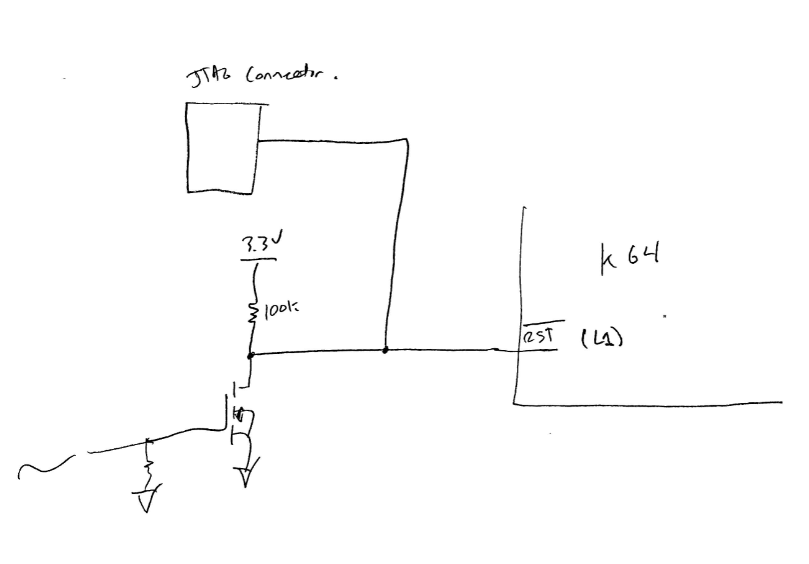

I have a new PCB with a MK64FN1M0CAJ12R micro that we cannot program via JTAG.
I believe I have traced the problem down to the /RESET line.  On this PCB, the reset pin onthe K64 connects to an external connector, a 100k pullup resistor, and an NFET that shorts reset to GND for about 400ms upon power up.
Simplified schematic drawing below:

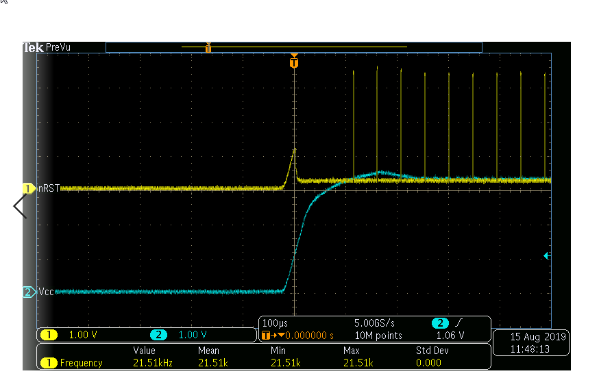

After power on, it appears that the reset pin is being pulled low inside the micro itself.  Every 50us or so it looks like the micro attempts to release the pin and allow it to be pulled high through the external pullup for about 1.5us, then it clamps back down and yanks it low again.
See the attached plots. (blue is Vcc, yellow is /RESET)  Also note that these pictures are with the NFET removed, so as to get a better view of both the power supply rise and the reset behavior in the same picture - with the NFET installed, there is a ~400ms period where reset is shorted to ground through the FET.

Reset toggling is normal for an un-programmed device: see explanation at  https://community.nxp.com/thread/487494#comment-1072401

Hi Geoff Gross,
Please refer: How To Sucessfully Program a Custom made Kinetis Microcontroller Board.
Notice the circuit of NMI_b and JTAG port.
NMI_b: make sure to connect 10K pullup resistor
JTAG_TMS: make sure to connect 10K pullup resistor
JTAG_TCLK: floating or connect 10K pulldown resistor

Thanks Robin - we do not have the pullup/downs on TMS and TCK - I'll add them and see if anything changes.  (Although we've used this same pullup/down-less design on several other boards, and this is the first I've been unable to program.)
