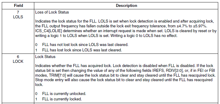

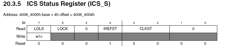

mjbcswitzerland
Specialist V
The ICS in the KE04 doesn't have a PLL, but instead just the FLL. The FLL will continue oscillating even if its external reference is removed (which it locks its frequency too and doesn't derive its frequency from) but will oscillate at its natural rate rather than being locked to the reference.
Check the details about the lock and and loss of lock flags to check that they are reacting as expected:
