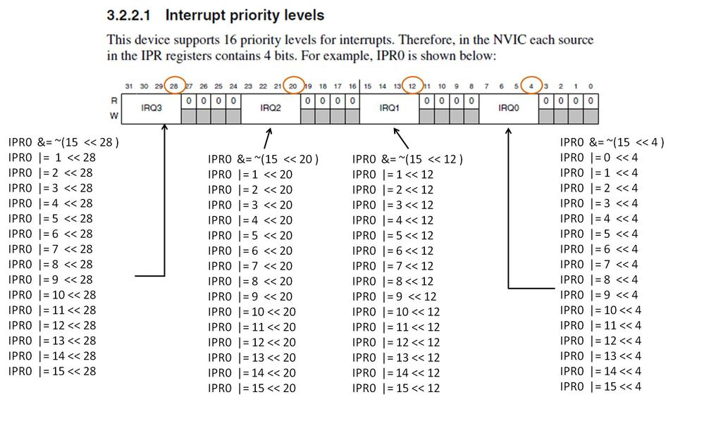

isaacavila
John,
What Santiago tries to tell you is that for each IRQn vector, there are 4 bits reserved to set the priority (0000 - 1111 value for each IRQ), so it is easier to set them as 0 to 15 instead of all decimal value (0,16,32,48, ..., etc), for example, for first 4 IRQ vectors, it would be easier to set their priority as follows:
As you can see, the first value indicates the priority level and it is easier to understand which priority level you are setting instead of using 32, 64, 128, ... values.
Isaac

santiago_gonzal
Hello John,
It depends how you rotate them, of course. Values 0-15 will need to be rotated 4 bits more than values 0-16,32,etc...The interrupt priority is given by a 4 bit field register. For me it would be more intuitive to write values 0-15 and then rotate them as needed by each register.
Santiago
