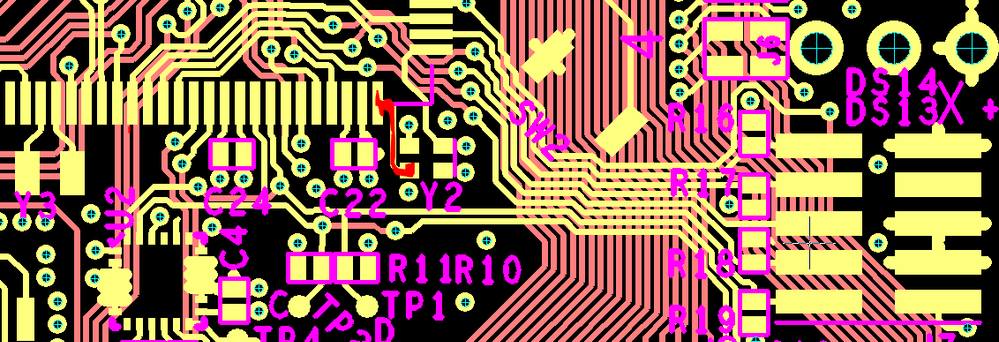

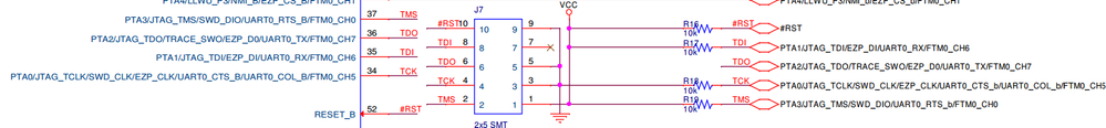

I'm attempting to bring up a board that I designed, and I'm having no succes connecting to the K64FN1M0xxx12 over JTAG. I've got the 100pin QFP. The JTAG header is about 1" away from the target IC, and each of the traces has 2 vias, with the exception of the reset. I'm not using USB, and have left VREGIN and VOUT33 floating. All VDD pins, VBAT, VDDA, and VREFH are connected to the 3.3v rail.

  • verified my schematic and PCB layout, noting pins and placement of power supply lines, JTAG lines, and JTAG pull resistors. (images attached)

  • disabled 8MHz CMOS oscillator (trace highlighted red on PCB layout below).
  • verified no 8MHz noise on JTAG lines.

  • I read in the K64 manual that the pull resistor value is supposed to be 100k, but I pretty much just copied my k20 design, which worked with 10k resistors. I don't have 100k resistors to hand right now, so I haven't tried this.

Schematic snip:
showing pull resistors and JTAG connections. Pin order on the JTAG header matches the pins shown in the PCB snip.
PCB snip:
100LQFP. Pin 26 is the leftmost pin on this snip. Aside from the JTAG lines, none of the other lines have signal on them, with the exception of the clock output, highlighted in red. There is a ground pour around traces on the top, and layer 2 is a ground plane, which is unbroken for the run between the header and the vias around the middle of the page. The JTAG connector is bottom right.
What am I missing? Anyone have a suggestion for something else I should try? I've got a FRDM-K64 that I've tried connecting to as well, but haven't had any luck with it either.

OK folks. Found the problem after consulting this: How To Sucessfully Program a Custom made Kinetis Microcontroller Board.
Step 2: pull up the NMI.
I have connected mine to another peripheral's interrupt line, and forgot the pull-up.
