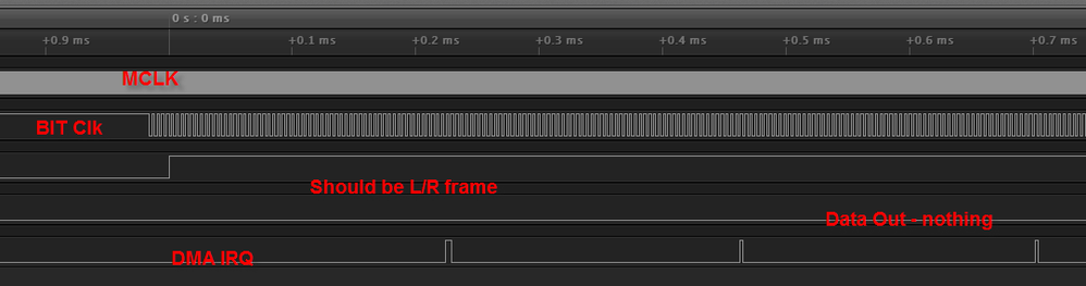

My I2S appears to be partly working and I can't figure out what wrong.
I have a custom K64 board that I2S is driving a TI audio chip.
I have read and studied AN4369, AN4520, AN4800, and the code associated with AN4369.
My K64 is running at 120 mhz.  I have 2 audio buffers that hold 1024 (L and R) 16 bit audio values.  I have DMA set to load 4 bytes every load sequence and request an interrupt every 1024 events.
For the test, I am using a sample rate of 8000 hz and a MCLK of 12.288 Mhz.  Given I want a frame size of 2 words (4 bytes) - my bit rate is 256000 hz.  I have verified the bit freq and the MCLK freq with the logic probe capture shown below.
I instrumented my DMA IRQ to toggle an output to show when my DMA interrupts are occurring ... last logic line on image below.
Here is my code ..  I hate posting code ... but I can't see my problem

I'm not grasping something about this I2S device.
Why are there 2 TDR registers? (TRD0 and TDR1)
Why are there 2  I2S0_TXD pins on the device?  (I2S0_TXD0 and I2S0_TXD1)
I'm only using the TRD0 register and the I2S0_TXD0 pin -- I'm expecting a 2 channel (stereo) output.  Is this assumption incorrect?
I tried an experiment to help isolate my issue.
I removed DMA from the picture altogether.   I set a loop where the cpu looks at the I2S_TCSR_FRF flag (fifo watermark says load data) and loads a left channel 16 bit value followed by a right channel 16 bit value.
while(1)
      R1 = I2S0_TCSR;
      R2 = I2S0_TFR0;
       if(R1 & I2S_TCSR_FRF_MASK)
             I2S0_TDR0 = 0xff00;
             I2S0_TDR0 = 0x8001;
My understanding of how I programmed the I2S was I wanted a frame of 32 bits where the first 16 bits where L channel and the last 16 bits was the R channel.
I captured the I2S0_TFR0 to see what the FIFO pointers are.
I'm puzzled -- since the I2S_TCSR_FRF_MASK is set (watermark level reached) but the I2S0_TFR0 register shows WFP (write fifo pointer) is 9 and RFP (read fifo pointer) is 1.
As you can see by the capture of the I2S0_TXD0 pin -- the I2S device outputs two of the L channel data (0xff00) and none of the R channel data (0x8001).  The L/R Frame line is not indicating the frame properly (L/R) .. it shows a continuous L -- which is what is being sent.
Only 2 samples are xmitted (both L channel value) and then nothing else -- why??
Can anyone with Kinetis I2S experience please comment?
Thanks.
