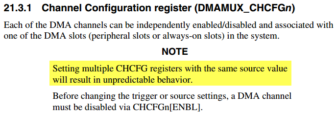

Hi,everyone, I found a question when using ADC. I set four DMA chanels, the first used to transfer the ADC chanel for ADC0, the second used to tranfer data after the finishing of ADC0 convert. The third used to transfer the ADC chanel for ADC1, the fourth used to tranfer data after the finishing of ADC1 convert. I want to get the ADC0 data and ADC1 data at the same time to calculte the angle of the two data series, so i set the same  soure request for DMA1 and DMA3,both PDB request. However, I found one of the datas order is wrong when the two ADC works using the same PDB?

In the K64 Reference Manual​, in the section 21.3.1 you can see a note which says that you only can use one channel at the same time:
As I understood you want to trigger the DMA channels 1 and 3 through the PDB and you want to trigger the ADC trough the DMA channels (software trigger). As the reference manual says, you can not configure the CH1 and CH2 to start the ADC through the software trigger at the same time but you can configure the hardware trigger in both ADC instances so you will not need the DMA.

Thanks for your answer, but configure the hardware trigger in both ADC instances will introduce another question. Here,I want to collect Ua,Ub,Uc,Ia,Ib and Ic, The collection of Ua,Ub and Uc finished by ADC0. ADC1 finish the others, so the ADC chanels must be transfered at the same time. I cannot transfer the chanels when using the hardware trigger by PDB? If I set two different request soure for DMA1 and DMA3,maybe FTM0 and FTM1,can it work ok?

You can trigger both ADC instances at the same time and you can avoid that the ADC triggers the DMA because that could cause errors. Maybe read the ADC values in an interrupt is a good solution. The value converted by the ADC is the one present at the moment of the conversion, it does not matter if you read those values at different time.
