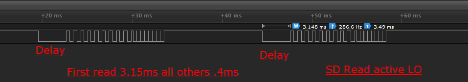

I'm seeing some performance differences between micro sd cards and have found a behavior I don't understand.
K64 running with 120mhz clock.
SDHC used in SD 4bit mode - clock 40mhz
Block read acquires 1 sector of 512 bytes - polling to complete.  I have included the code below.  I added an LED to the read code so that I could acquire the trace below using a logic probe.
Every 25msec my application acquires around 18 sectors for the sd card (sector is 512 bytes) - I turn on the LED during this acquisition period and the trace shows LOW during the read operation.  After the 18 sectors are acquired, the sd card is not accessed until the next 25msec tic occurs.
Behavior:
The first sector read following a non-use of the SDHC - that read takes over 3msec to acquire the data.  All other reads following the first only take 400usec - a factor of 10 difference.
I thought it might be due to the SDHC clocks gating off when no sd activity so I turned gating OFF - verified by scoping the SDHC clock line.  Disabling the clock gating operation makes no change in behavior.
Can someone please explain this?

Mark -- sanity check for me.
The initial delay is getting the sd card's internal up to speed - makes sense.
The remaining read times should be as fast as the card can do.
I know CMD18 would provide a short read time over many reads but I tested my app which uses a FAT32 file system and my read requests are never on sector boundaries - so there was little advantage to CMD18.
Now the sanity check - It seems my actual reads (after the first are still too slow.
I'm guessing the following math is close -- if not please correct me.
I currently see a read of 1 sector in 350usec
So that is 512 * 8 bits/byte = 4096 bits in the read package.
I'm using the 4-bit interface mode so that make 1024 bus events.
350 E-6 (usec) / 1024 = 3.42 E-7 bit timing == which equates to an bus event clock of 2.93 mhz.  My SDHC clock is 40 mhz.
THAT does not make sense!!!
Any ideas on why my reads are slow?
Just a note - my timing is AFTER issuing the CMD17 - so timing associated with is not included.
Thanks.
Joe

mjbcswitzerland
Specialist V
Joe
With 50MHz SD card clock a read can be performed in about 20us.
With 25MHz it is about 40us.
With a little SW overhead maybe 60us.
I use DMA for the read, which isn't that much faster since a tight loop gives about the same, but it helps if there are other interrupts that can disturb the loop.
Check that your read buffer is long word aligned - if it isn't it slow the process down since the Cortex has to split the write into multiple bus accesses and the overall operation may be > 4x slower.
Mark

mjbcswitzerland
Specialist V
Hi Joe
If you are reading linear sector from a card you need to use CMD18 (multiple block read) in order to get best performance. The single sector read CMD17 is slower. The first read of multiple sectors is however always slower (whichever command used) since the SD cards internal logic needs to get ready - subsequent linear sector reads are then faster.
The uTasker SDHC card interface reads an initial sector in about 450us and subsequent ones in about 50us (using CMD18). This allows HS USB-MSD operation (eg. on K66) to achieve around 20MByte/sec transfer from the SD card to the PC.
