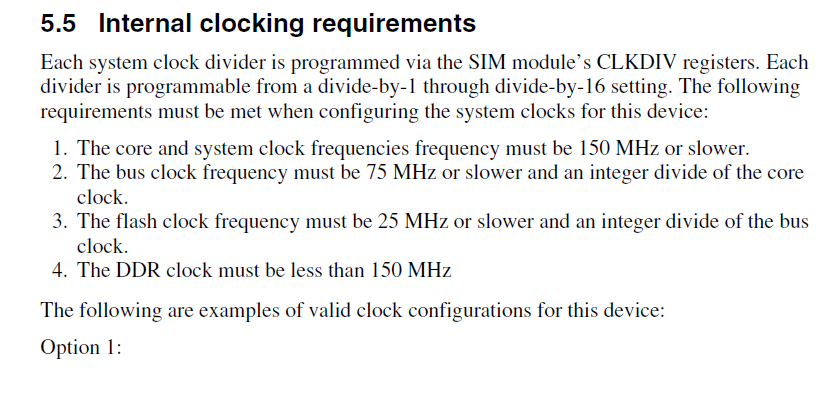

Hi, The following section is taken from the K61 reference manual K61P256M150SF3RM.
Per #4: 'The DDR clock must be less than 150 MHz'  is that means it cannot run at 150 MHz ?
Tags (3)
1,344 Views
Jonathan_Iglesias
Dear Moshe Yotam,
I think this is an error in the RM, you can use the DDR as 150Mhz or less.
