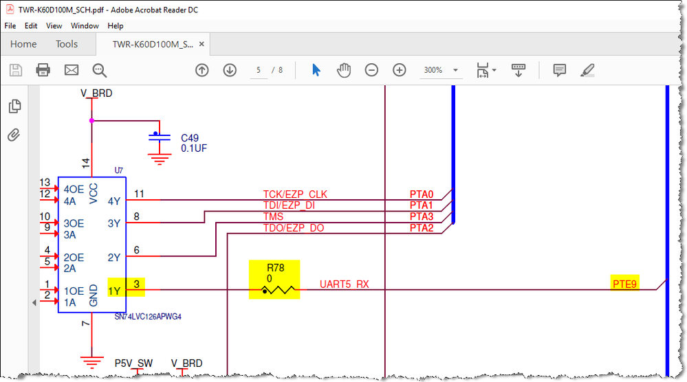

Robin_Shen
Would you please check if the PTE9 connect to other device?
For example: the PTE9 connect to U7 by R78 on TWR-K60D100M board. If you remove the R78, then the output value should meet what you needs.
Robin

Robin_Shen
I try to remove R78 of TWR-K60D100M board.
During debug, after last line I get 0.1v on this pin.
