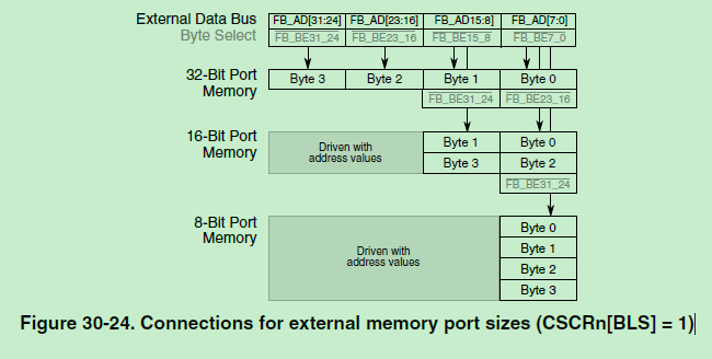

Hi Andrew,
You are using Flexbus in multiplexed mode.
For the Flexbus 16bits data lines at FB_AD[15:0] pins, it need to set CSCRn[BLS] = 1, more detailed info, please check below picture:
And it need to check the hardware connection, for it using 16-bit data port, the CPLD address A0 pin should connect with Flexbus_AD[1] pin.

Thankyou very much for your quick reply. I forgot that I had commented out the BLS=1, thanks.
We currently have the CPLD Address[15:0] pins connected directly to AD[15:0] through an address latch. Looking in the reference manual K60P144M150SF3RM.pdf, section 33.4.1.2 says that the address and data lines should be connected from FB_AD0 upwards, however on the next paragraph it says that a 16 bit device connects to FB_AD[16:1]. Do you have any more information or an example schematic on why it starts from FB_AD1 and not FB_AD0? Should the FB_AD0 line be connected to anything?
Many thanks again
