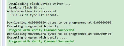

Hui_Ma
Hi Jeff,
I fix this problem on my PC, what I have done is at first to enter into the debug panel, after that,use Flash programmer tool without any problem. There shows download bytes to program address.
After that, I create a new project, without any modification, the Flash programmer tool also works. If you still meet same problem after enter into debug panel, you can restart your PC and try again.
Wish it helps.
with regards,
Ma Hui
