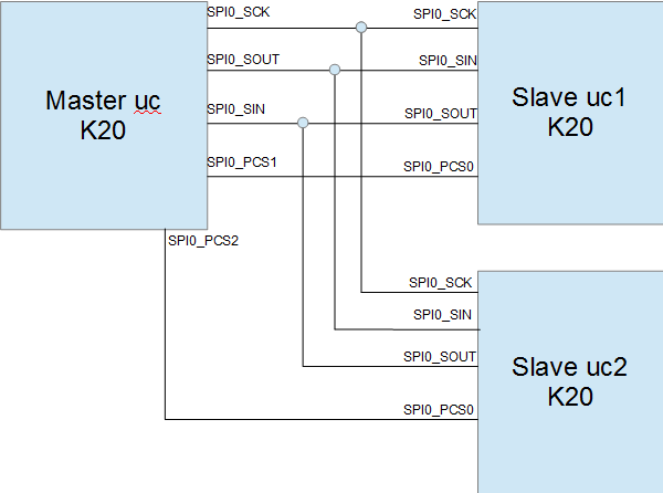

I was thinking if I can connect some sensors and 2 microcontrollers in the following configuration using SPI.
I.e the slave uc will act as a master for all the 4 sensors and will act as a slave for another uc and the distance between them is specified above. I have one more question. Do we need to add a buffer for 30 to 40 m distance communication ? if so can you tell me the part no.  which one will be most suitable ?

Hi Amir,
The SPI bus is intended for communicating devices which are close, preferably in the same board. 10-20m is a way too long distance for one SPI bus. Perhaps you should consider using RS485 or RS422, with high quality twisted pairs cable. Pay attention to the fact that a relation exists between the cable length and the max communication speed (bit rate).

VictorLorenzo
Hi Amir,
Using shielded cables and proper impedance adaptation and filtering you could connect to one I2C device even with one 1m long cable. We succeeded in doing it once using relatively low speeds (below 50KHz), but it was difficult to achieve due to low noise inmunity and high speed glitches that some times got the I2C states machines crazy.
I would not recommend using SPI for more than 15-to-20 cm as it will become complex to distribute the high rate clocks and signals (it is indeed complex even below 10cm).
If you're still evaluating the usage of SPI, perhaps this (http://www.ti.com/lit/an/slyt441/slyt441.pdf) note from ti will be of help for you. But it will add more cost than using RS485/RS422.

Amit_Kumar1
Senior Contributor II
Hello Victor
I was just trying SPI communication for small distance so just to verify if the block diagram is correct or it needs some modification?

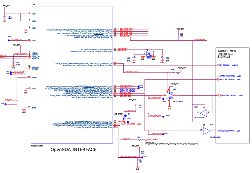

Actually I was going through the schematic of FRDM-K20D50 board. I found that open SDA is also connected using SPI but in this schematic they used 74LVC125ADB IC just before interfacing with Target uc.so Is there any need to connect this IC in above circuit ? as all the above  uc is working on 3.3V so I think I can interface it directly. correct me if I am wrong.

Amit_Kumar1
The SPI communication between 2 FRDM board was done successfully kindly refer this link SPI communication b/w two FRDM-K20D50M Boards the issue was with FRDM board. the J17 jumper is needed to be cut as it is connected to the accelerometer so the board was having problem in transmitting data . after cutting the track the board is working fine for SPI.
