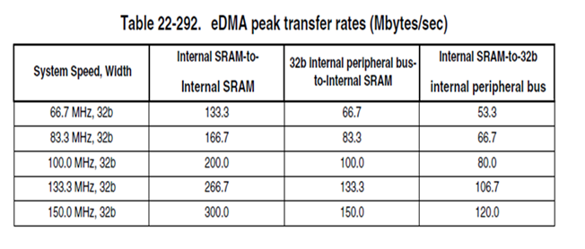

    3.  eDMA peak transfer rate
  4. Performance test
        With K60 100MHz (TWR-K60D100M), implement internal SRAM-SRAM eDMA data transfer. If  transfer size setting as 32-bit in TCD Transfer Attributes (DMA_TCD_ATTR), there will has one wait state during each read/write. That's why the DMA performance doesn't up to 200MB/s as the manual stated.
      We highly recommend setting DMA transfer size to 16-byte at DMA_TCD_ATTR register, it will much increase the DMA performance.(Get 162MB/s transfer rate with TWR-K60D100M board.)
