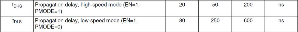

Is there a specification for the propagation delay of the K60 comparator input to output (continuous mode)?  The reference manual calls this Tpd, but I haven't been able to find an actual value.

Hi Brian,
You can find this value in the datasheet, just as the Fig 1 shows.
Please check the datasheet through the link as below by yourself.

I must have overlooked it before.  Thanks!
