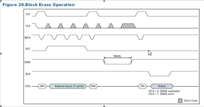

2- NFC_CMD2[MODE] (see jpg) defines a sequence of NAND operation.  I can correlate that to the example (see jpg example) for page read, write, reset, block erase.

my question is: can use NFC_CMD2[mode bit 8] to send limited amount of data for general purpose or this mode bit 8 is only used for page write?  It seems that the erase block command uses the command byte 2 to send the actual data.  there maybe cases that i want to send 4 bytes of data to configure the NAND, how could i do this?

  1. You can set NFC_CMD2[8]=1 to send data to Nand Flash, it is not only for page program.
The size of data is defined by SECTOR_SIZE.
The block erase command is 60h+ADDR+D0h (+70h+read status), I don’t see any data output here.
You need to set
CMD_BYTE1=60h, CMD_BYTE2=D0h, and CMD_CODE=16’b0100_1110_1101_1000
If you want to send 4 bytes to Nand Flash, just set NFC_CMD2[8]=1 and SECTOR_SIZE=4.
