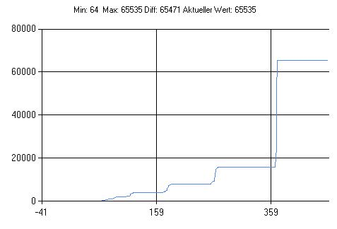

We see ADC failures on meanwhile the third unit with a K60 (MK60DN512VLQ10 - 4N22D) from different pcb lots. They return gross stepping values from a linear voltage ramp on the input. There are no failures (yet) reported by the customer, the problems all appeared during software development.
The board already underwent overload tests on the inputs of -24 to +48V and full EMI testing (4kV burst and 30kV ESD) without failure.
We are using the ADC0 & 1 inputs ADCx_DPx for measuring 0..10V (AIN3..4 in our schematic) and 10..100kOhms resistance (AIN 1..2)  and the K60 temperature sensor.
The ADCs are set to 6,25MHz, 16 bits, DIFF, Vref=3.3V, AV=32.
DAC0 drives a 4..20mA output circuit and continues to work correctly on the faulty boards.
Faulty stepping response from a ascending input signal (ADC Mode for this Test: 16Bit, DIFF=Off, REF=ALT)
Differences in register states (Temp Sensor, 16Bit, Diff, REF=3.3V) ("K60ADC-good-registers.jpg" and "K60ADC-faulty-registers.jpg")

In our overload tests we have seen the following currents and voltages which all should not lead to a circuit damage.
U_AIN3_4: -24V (20x 1s):
U_SP721:     -0,69V
UinADC0_DP1: -0,561V
IinADC0_DP1: -130uA
U_AIN3_4: +48V (20x 1s):
U_SP721:     +4,08V
UinADC0_DP1: +4,00V
IinADC0_DP1: +80uA
U_AIN1_2: ESD Contact +/-2KV (20x) : OK
U_AIN3_4: ESD Contact +/-2KV (20x) : OK
Hence we have no idea where the faults have there origin. Any ideas?

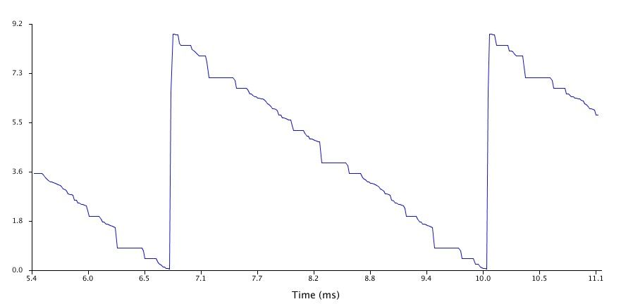

Mike, I know this ADC problem happened years ago, but I now have exactly the same problem on a K66 and wanted to know if you ever found a root cause. In my application, I run one ADC channel (on adc0)  in single-ended mode at the maximum continuous speed for 16-bit.  Then, I stop acquisition, and restart it frequently (eg 30Hz) since data is acquired sporadically.  After 3-5 days of correct operation, the ADC always fails spontaneously in the same way:  it still produces a result, but the digital codes do not correspond exactly with the analog value.  I attached a test waveform, which should be a smooth sawtooth.  I've added protection diodes, higher value resistors on the inputs, changed grounding methods, and cannot understand why the chip dies.  Let me know if you ever learned anything about this. Thanks!

we have no more Fails (Kinetis CPU's with damaged ADCs), since we limit the max. Input Voltage to <3,2V. (Clamping Diodes now to 2,5V). Are your ADCs also damaged like ours (no more correct Function after power on) ?

Mike, thanks so much for your quick reply.  Yes, in my case, the adc is permanently damaged, and switching to a different pin on the same adc doesn't help.  It's interesting that your solution of clamping to 2.5V worked -- maybe these chips are incredibly sensitive to overvoltage transients.  I'll have to give that a try.

Thank you for commenting again on my problem! Following your advice, I tried to test and simulate over- and undershoots on the reference. In LTSPICE it would indeed result in 0.6V (30mV without the 10uF) excursions from a full step VCC change in a few microseconds. In reality, I couldn't produce more than 200mV changes. So next I applied short pulses (less than a second) of 1V (up to 1A) positive and negative at Ref-/Vssa Pin (to force a fail).The ADC values would be affected during these pulses but the ADC returned to proper operation despite many such cycles.
Hence, while we will definitely follow your advice and short L7 while reducing C7 to 10nF, we don't think that this really solves the problem. One of the reasons to be doubtful is that on the first failing unit it was one channel only that failed in the beginning. Though the other followed later, this speaks against a Vref cause. Any other idea?
