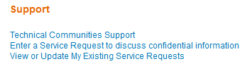

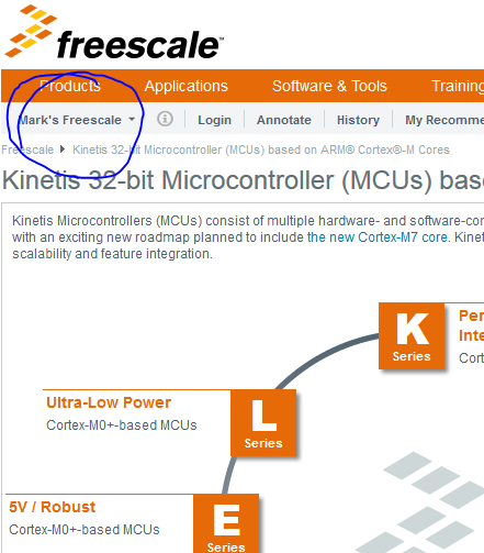

mjbcswitzerland
Specialist V
Bruno
You need to login to your "My Freescale" acount
Here it shows as "Mark's Freescale" and yours will presumably show as "Bruno's Freescale"
and then there you have:
Mark
http://www.utasker.com/kinetis.html
3,582 Views
brunopaillard
Thanks again Mark!
I just sent it.

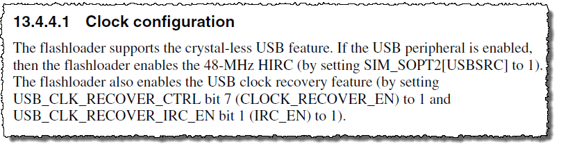

mjbcswitzerland
Specialist V
Jorge
I am interested in the K22 pre-loaded version due to the fact that the KBOOT loader generally assumes a certain clock (oscillator or crystal) so that it gets its speeds right.
Since when a chip is delivered it is not possible to know what will be clocking it in the final circuit it must be based on internal clocks instead.
In this post Re: Re: USB boot loader for K64FN1M0VMD12 ? (towards the end) I have made a version of the KBOOT USB loader for the K64 which supports USB, based on the IRC48M, which allows crystal-less USB operation (also explained in AN4905). Is it therefore true that the K22's pre-installed KBOOT loader supports USB by utilising its crystal-less USB capability?
On the other hand, it would presumably mean that any Kinetis types without IRC48M will not be able to support USB loading based on a pre-installed KBOOT version unless the oscillator/crystal used is also pre-defined. Are these presumptions true for the pre-installed KBOOT restraints?
Mark
3,584 Views
Jorge_Gonzalez
Hello Mark:
This is an extract from K22 reference manual (Chapter 13 Kinetis Flashloader):
So your assumption is correct.
About the Kinetis parts without IRC48, that is an interesting question, but I have no information about it right now, sorry.
Regards!
Jorge Gonzalez
