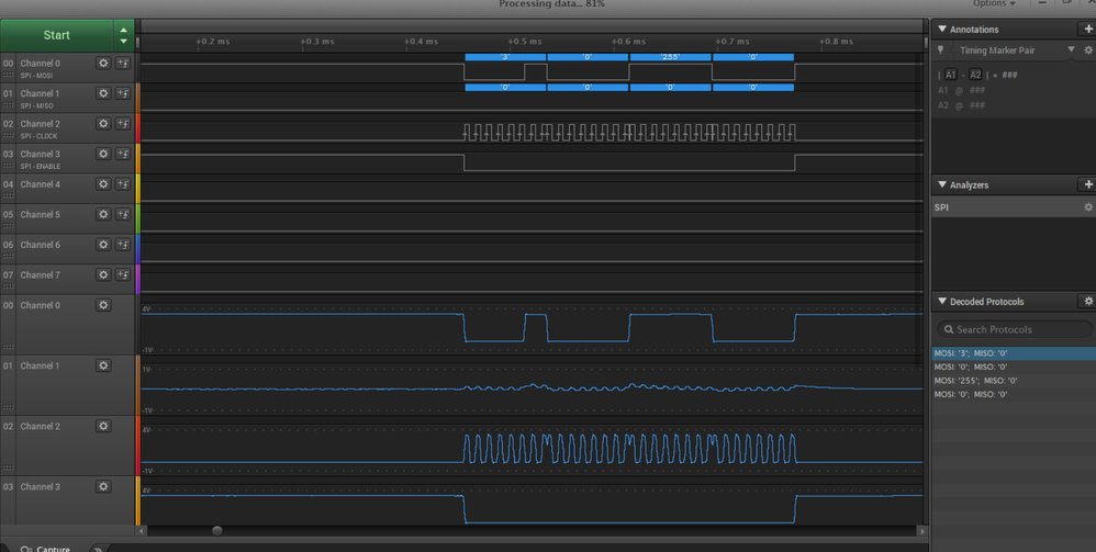

Once you have sent the command and 24 bit address you need to send further data (eg. 0x00 or 0xff) in order to generate the clock to read data in. The CS line must remain low during the data read.
You will also need to read the data that was returned during the command and 24 bit address and discard it in order to make place for the data input that follows.
If you are sending extra data to clock in the data bytes but this is not making it to the SPI bus it probably means that you are not waiting for the FIFO to have enough space to accept them and overflowing the output (which will then lose the data). Depending on which physical SPI is being used your will have ether a 4 deep or 1 deep FIFO so the behavior could also be different on different SPIs if the wait is not implemented correctly.

burgeh
So I found this Processor Expert has a component named "SPIMaster_LDD" which has some basic methods to communicate via SPI. I am able to send data fine, but I am not able to receive. This is due to the driver not sending a clock signal to clock in the incoming data. Attached is an image of the trace. I send 0x03h and a 24-bit address ( as protocol for the winbond W25Q128JV). But as like all other SPI I need to be able to clock in the data. Is there a method I'm missing otherwise how else could I generate this clock on the standard SPI pins? The other image displays how the flash device is connected to the MK22fn256VLH12. I've ensured the voltages are correct and the device is setup correctly.  I tried to add another 0x00h to make a "fake" clock. Still nothing.
