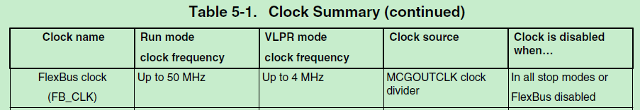

This is my configuration of FlexBUS for IS61LV256AL SRAM (http://www.mouser.com/ds/2/198/61LV256AL-258426.pdf) and MK22FN512VLL12
    FB->CS[0].CSCR  =   FB_CSCR_PS(1)      // 8-bit port7
      | FB_CSCR_ASET(0x0)
   | FB_CSCR_RDAH(0x0)
   | FB_CSCR_WRAH(0x0)
      | FB_CSCR_AA_MASK    // auto-acknowledge
   | FB_CSCR_WS(0x0)   // 2 wait states
   | FB_CSCR_BSTR_MASK
   | FB_CSCR_BSTW_MASK
    FB->CS[0].CSMR = FB_CSMR_BAM(0x7)  //Set base address mask for 512K address space
      | FB_CSMR_V_MASK    //Enable cs valid signal
With this code, read of 8-bit wide data takes 5 FlexBus cycles. However, reference manual (http://www.nxp.com/assets/documents/data/en/reference-manuals/K22P121M120SF7RM.pdf , page 711) states that it should take only 4 FlexBus cycles.
Is it possible to improve performance of FlexBus read in my case?

First of all, sorry for the later reply.
Could you check the Flexbus clock frequency setting?
From the K22 reference manual, the FlexBus clock Max. frequency is 50MHz:
Please check System Clock Divider Register 1 SIM_CLKDIV1[OUTDIV3] bits value, which related to Flexbus clock frequency.
Wish it helps.
