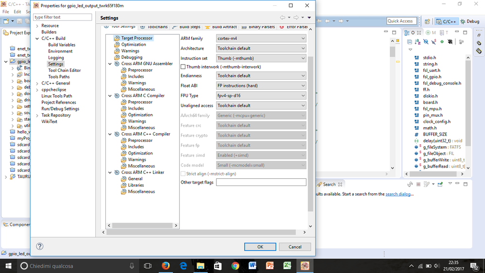

Hi everybody,
I have written a program on the K65 MCU which performs some controls and a few calculations. Looking at execution times I found out that the calculations performed were the instructions that took the most time.
These calculations are simple multiplications between float variables and I think that some micro-seconds for each multiplication is really too high, considering I have a 120 MHz clock! probably there is something missing in my code or there are some compiler options which I have not set properly so I am asking you:
  • is there any compiling options I can enable in order to use the math co-processro provided with the ARM -M4?
  • is there any libraryI can laod to use the "DSP Instructions" described in the ARM -M4 reference guide?
Cheers,
Giulio

Do you compiler for HW  FPU use?
These flags are needed by GCC:
-mfloat-abi=hard -mfpu=fpv4-sp-d16
Mark

Yes, these are my compiler settings:

Besides to set the compiler, it also need to enable FPU with below code:
; Enable the floating point coprocessor
#if defined (_VFPv4_)
      MOVW r1,#60808              ; load CPACR
      MOVT r1,#57344              ; (0xE000ED88)
      LDR r0,[r1]
      ORR.W r0,r0,#VFPEnable      ; Enable FPU
      STR r0, [r1]                ; on CP10, CP11
      MOV.W r0,#R2N_Enable
      VMSR FPSCR, r0
#endif
Wish it helps.
Ma Hui
