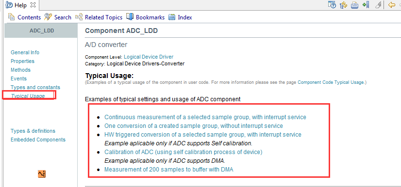

- About the other channels ADC1_SE4b, ADC1_SE5b and ADC1_SE6b, please first refer
to the Typical Usage demo to check whether it can work well :

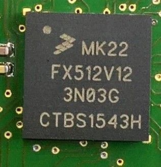

CPU is typo: correct is MK22FX512VMC12 in MAPBGA 121-pin package

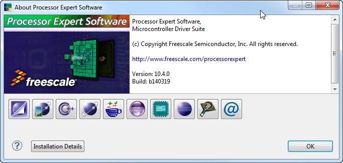

I'm using Processor Expert Software 10.4
