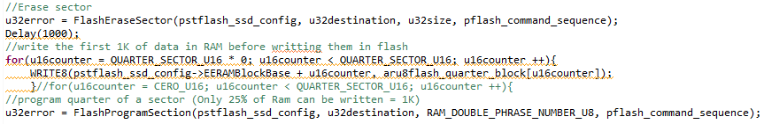

Hi all,
Im working with MK22FN1M0AVLL12. It has 1MB of flash (2 flash blocks and no FlexNVM memory)
My code is into block 0 and the issue happens when i try to erase a sector which is into this block 0. (erasing into block 1 is ok).
I am not using any interrupt so I guess it is because it is not possible to execute code and erase a sector which is into the same block at the same time, am i right?, should i execute the erase and program code from RAM so it can works?

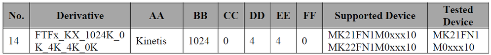

Your device doesn't have HIGH SPEED RUN mode and so I made a mistake suggesting that it may be related to that. The K22s with FlexNVM do have it in order to be able to operate faster than 80MHz, with some restrictions such as Flash:
The difference between K60 and K22FN1M0 Flash is that the K22 uses phrase programming rather than long word programming but I don't know any differences when erasing.
The K22FN1M0 is equivalent to the K21FN1M0 with respect to memory so you could try to run the following binary (it allows Flash to be erased, programmed, etc, in the I/O memory if you can get it on the UART or USB) on your board: http://www.utasker.com/kinetis/TWR-K21F120M.html to verify operation. The flash commands are described in http://www.utasker.com/kinetis/KE_EEPROM.html (valid for RAM, EEPROM or Flash).
I don't know the Flash driver you use but check that the K21 doesn't require a different one (that is, take the Flash driver from a K21FN1M0 example rather than a K22 one).
In case of further problems just use the uTasker Flash driver since it is suitable for any part (KE, KEA, KL, KV, KM, Ks).

alubeiro
Hi Mark,
The driver i am using C90TFS, has been tasted in a lot of devices. In my particular case (MK22FN1M0), it has been tasted in MK21FN1M0
In anyways it is working well as long as i erase sectors which are in block 1 so the code works well.
Now, i have the "pFlashCommandSequence" allocated in RAM but still cant erase sectors in block 0.
I wonder if there is anybody working with the same K22 as me and with C90TFS driver.
Im working with a customized board.
Thanks and best regards.

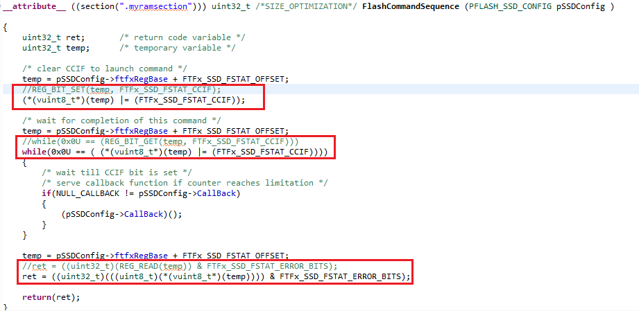

alubeiro
I have resolved the issue.
It was due to some code macros which were called inside the "FlashCommandSequence" function.
they should me relocated in RAM also or just put the code without the macro into the function which is already alocated in RAM
12,032 Views

alubeiro
Hi Mark,
As you see i have had to put the Macro's code instead the macro itself otherwise i couldn't write code in flash block 0.
This way the whole function is alocated in RAM "myramsection"
So i have had to modify library code.
In any ways it works fine in block 0 as long as i am debugging step by step. I mean going over the "FlashEraseSector" function by one step, then let it run still "FlashProgramSection"  function and then go over it by one step too.
If i let the code run, the MCU resets.
I have put a delay between the sector erase and the sector program but nothing has changed.
Any idea or test that i can do?
Thanks and regards

mjbcswitzerland
Specialist V
Hi Alberto
"Stepping.." I thought you stepped the code in SRAM and all was OK - this would not have tested the call-back since the stepping would have been slower than the programming and so the flag never in the appropriate state. If you step over the routine there is no difference.
I cannot explain anymore what you are seeing. Maybe your HW has a problem (programming current causes supply to dip)?
I have attached the uTasker Flash driver again in case you want to compare anything.
Mark

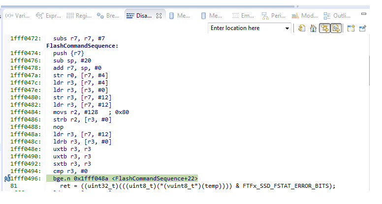

alubeiro
The last thing i have seen is that the furthest it goes without being reseted is the break point which is inside the disassembly window.
This breakpoint belongs to the "while".
Any help will be appreciated.
Thanks and regards
PD: Remember that this issue happens with addresses that belongs to block 0. up to 0x7FFFF

mjbcswitzerland
Specialist V
Alberto
It looks like the while loop is never being quit - do you have the watchdog active? Also, when there has been a reset do you know what the reset controller reports as cause for the last reset?
The code looks Ok but it has been written in a way to make it as difficult to understand as possible....the following is easier to understand but exactly the same (there is no need to do the error checking in the RAM code - you can do it after it has returned.
static void fnFlashRoutine(volatile unsigned char *ptrFTFL_BLOCK)
    *ptrFTFL_BLOCK = FTFL_STAT_CCIF; // launch the command - this clears the FTFL_STAT_CCIF flag (register is FTFL_FSTAT)
    while ((*ptrFTFL_BLOCK & FTFL_STAT_CCIF) == 0) {} // wait for the command to terminate
and called with
fnRAM_code((volatile unsigned char *)ADD_FLASH_STATUS_REGISTER);  // execute the command from SRAM
Mark

mjbcswitzerland
Specialist V
Alberto
It is normal that it is not possible to erase sectors in the plane that the code is running in and so te code needs to be run in RAM instead. However, are you sure that you have correctly located the code in SRAM and are correctly calling it as a THUMB routine? If not the code will crash, even if the code is otherwise correct.
The simplest way to find out is to set your debugger to disassemble mode and step the code being run in SRAM (Flash programming only normally requires 6 THUMB instructions in SRAM so it is easy to check that they are operating correctly or whether the reset you have us due to invalid SRAM code).
Also check the status in the reset controller to see what type of reset it was.
Does the library code that you use not automatically handle code re-location etc.?
