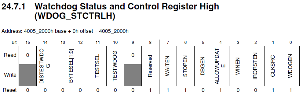

alubeiro
Hi Mark,
The watchdog is not enable. It is disabled at startup.The register is settled at "0x01D2" value
As for the reset, the active flag in "RCM_SRS1" register is the "lockup" flag
There are not protected Flash regions as all "FPROT" registers are 0xFFFFFFFF
Sorry but I don't understand the code you have posted, i mean, inside fnFlashRoutine you clear the CCIF bit, which launches the command (this code should be in SRAM)
By the way i have tried to do the error checking back in flash but it doenst go any better.
Thanks and regards
