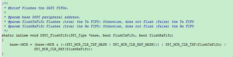

chuckhorkin
We tried this but nothing changed.  No surprise here because the SPI Slave transmit function, DSPI_SlaveTransferNonBlocking(), already calls DSPI_FlushFifo().

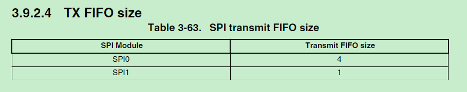

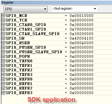

While, I find you are using K22 SPI1 module, not SPI0.
Please check below difference about K22 SPI0 vs. SPI1:
I also check the MCUXpresso V2.3 for FRDM-K22F board DSPI slave half-duplex-transfer demo, which is using SPI0 module with below register setting:
If you could change your application code with SPI0 module, then check if there still with the same issue?

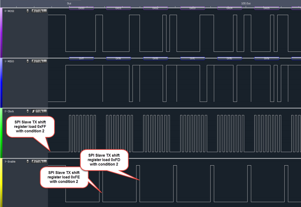

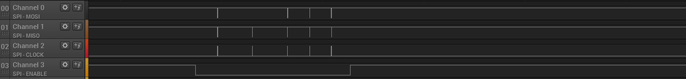

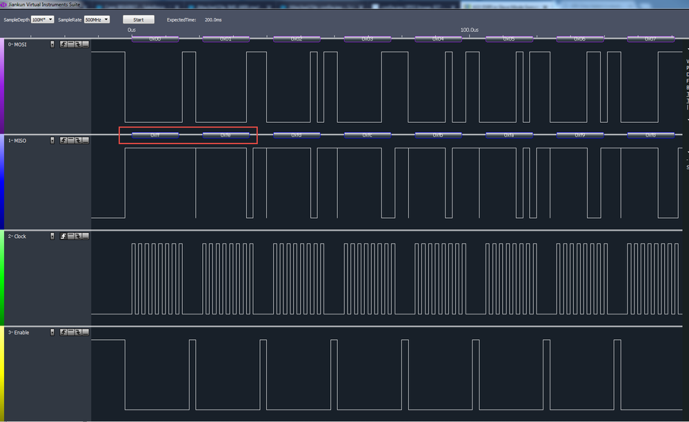

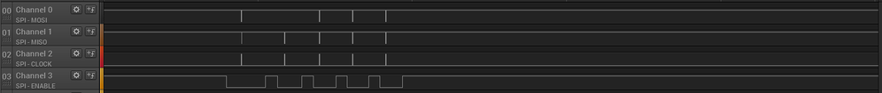

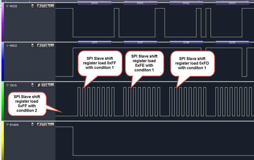

cheekaitan
Hi Mike,
I have some new findings after I use the example codes from KSDK2.3.0. I saw that if I were to toggle the SS line between bytes (as shown in the first image), the communication seemed to function without issue:
However, if I were to toggle the SS line between multiple-byte transfers (as shown in the second image), I would encounter the issue again:
Do you have any idea why I would see such behavior?
Chee
11,124件の閲覧回数
Hui_Ma
Hi Chee,
Sorry for the later reply.
I find the same issue from FRDM-K22F board.
With using the continue chip select, the first byte will be transfer twice.
The SPI chip select continuous asserted:
The SPI chip select is not continuous asserted:

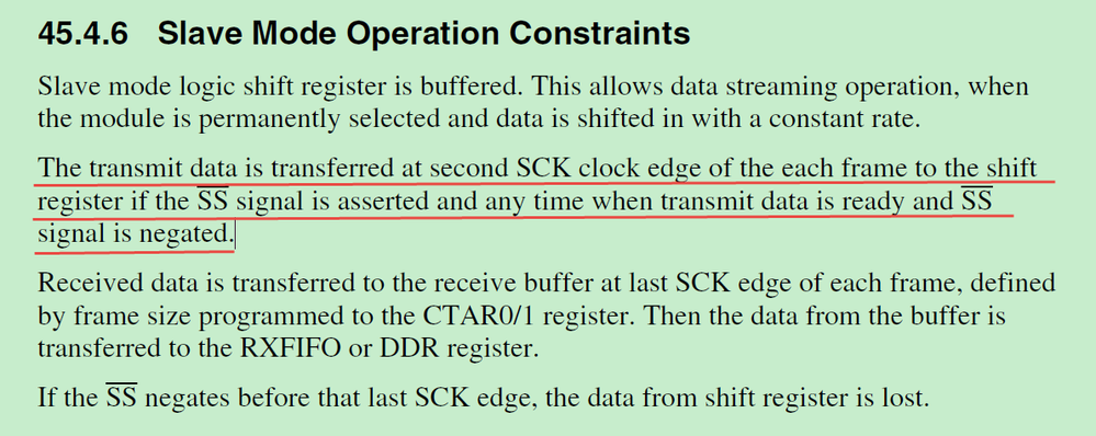

The K22 reference manual shows below info:
The SPI Slave shift register will be updated with two conditions (Or logic):
1> at second SCK clock edge of the each frame to the shift register if the SS signal is asserted;(shift register old value will continue be transferred, after that start to transfer the new value)
2> any time when transmit data is ready and SS signal is negated.(shift register value will be updated with new value, and start to transfer the new value)
So, when the SPI Slave TX shift register will transfer the first byte twice with SS signal continuous asserted.
When SPI Slave with SS signal negated will load new value to update the TX shift register.
My test software is based on [dspi_interrupt] demo with below path:
..\SDK_2.3.0_FRDM-K22F\boards\frdmk22f\driver_examples\dspi\interrupt
Wish it helps.
Mike
