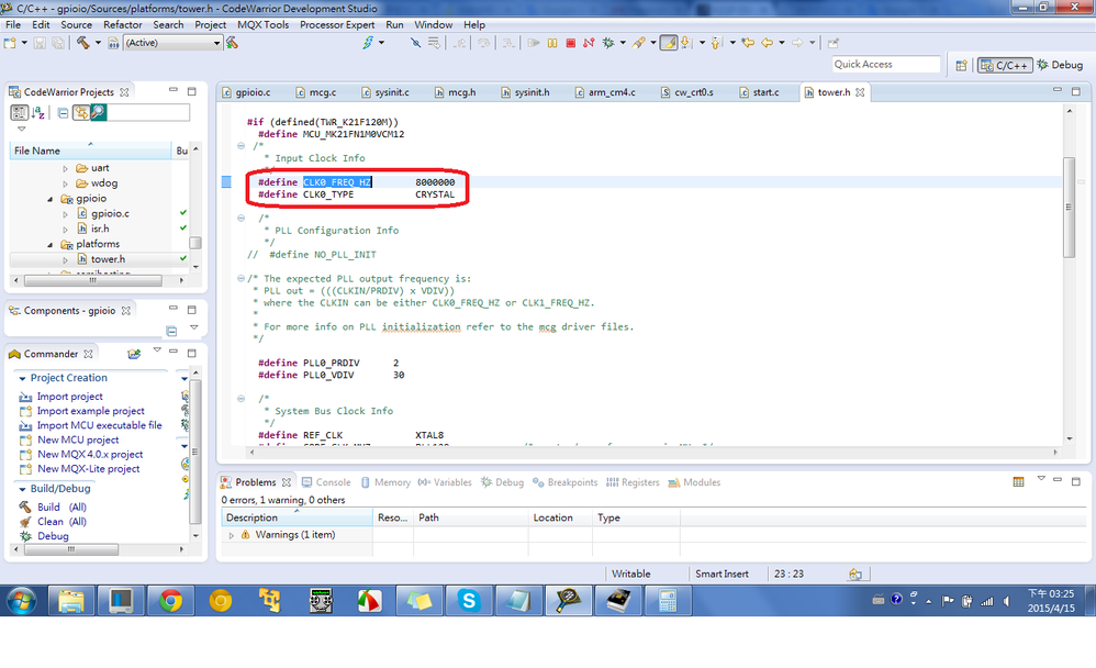

Dear sir, I have a TWR-K21F120M
But when I want to 8MHz OSC 12MHz OSC can not be replaced by normal routines.

Hi  ,
  Could you describe your question in details?
  Do you want to replace the 8Mhz crystal oscillator in TWR-K21F120M board to 12M crystal oscillator? Or you can't configure the frequent which you want?
  Please give me more details.

HI, I have a TWR-K21F120M
8MHz can work in normal operation with JLINK, but for a 12MHz oscillator can not normally in operation

kerryzhou
    How did you check the operation with 12MHZ oscillator? Change the 8Mhz oscillator to 12Mhz in the tower board?
    Did you use oscilloscope check your 12MHZ to see whether your oscillator is oscillating after you download the code which use the external osciilator?

HI,
After I changed the 12MHz OSC, with JLINK burn on code warrior Display IC continuously reset

kerryzhou
    Did you also configure your code with 12Mhz OSC? You should modify your code with 12Mhz external OSC instead of 8Mhz code.
    Beside, did you check your 12MHZ wave in the oscillator, whether it is oscillating?
    Please tell me more information.

HI !
In other oscillator to change the following?

kerryzhou
    Yes, Change this data to your real oscillator data:12000000 . then try again.
