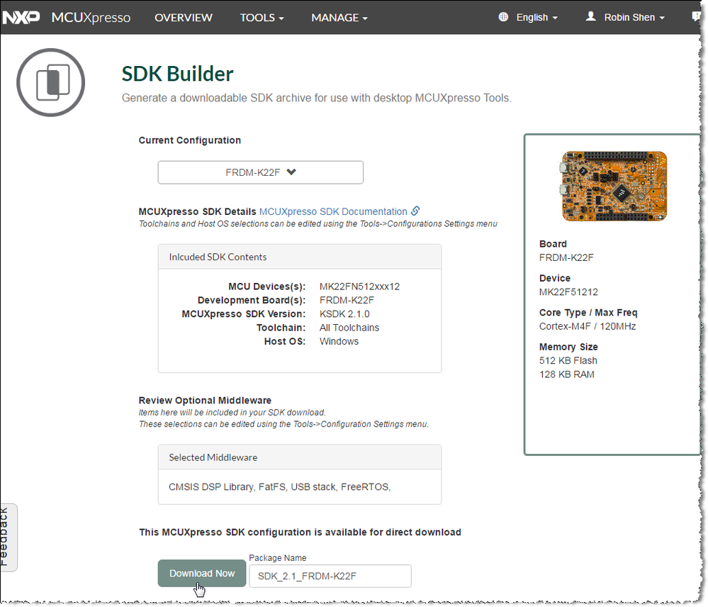

You can refer the demo "ftm_quad_decoder" in KINETIS-SDK.
For example: search K22 then select FRDM-K22F and download SDK_2.1_FRDM-K22F.
You can getting start with KSDK reading "How to start with KSDK".
