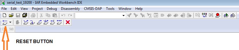

  • If I run code after loading in EWW, the code will run into main and start following steps.
  • If I preset "reset" in EWW, the code runs away and stops only at pll_init().

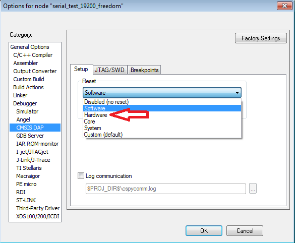

I tested the issue you are reporting and this is what I found. When you are using CMIS-DAP or some other debugger tools you have the option to configure the way of the reset when you perform it in the IDE; in IAR is when you press the reset button.
In the debugger options of the project you can change the way this reset is performed. If you select a software reset just the program counter is in reset state but the registers do not change. To ensure that all the registers change to their reset values you need to change the reset option for hardware reset.
I hope this information can help you.

Hi, Adrian,
Thanks for your information. That is an important configuration I never aware of.
