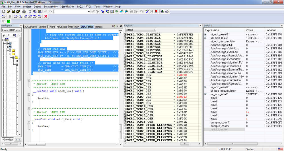

brentwilliams
Hi Alejandro,
I am seeing something unexpected.  I am trying to configure ADC1 to use DMA channels 6 and 7 along with DMA_MUX 6.  DMA channel 6 points to a mux of ADC 1 channels.  The MUX has 12 channels for ADC1.  DMA channel 7 points to ADC1_RA.
What I am seeing when I get my DMA channel 7 interrupt is the following (see inserted screen shot of DMA registers below):
             DMA_TCD7_CSR = 0x82 => GOOD – MAJOR COMPLETE AND GET INTERRUPT
DMA_TCD6_CSR = 0x00 => BAD, DID NOT INDICATE MAJOR WAS COMPLETE, EXPECTING 0x80
DMA_TCD0_CSR = 0x80 => WHY IS THIS UPDATED???  THIS IS SAYING DMA channel 0 completed a MAJOR LOOP I DID NOT CONFIGURE THIS
I am not sure why anything is happening on DMA channel 0??  I am not configuring it at all.  My configuration of ADC1 and DMA channels/MUX is below:

DMA_CINT                = DMA_CINT_CINT(7);                                  // Clear the interrupt flag for channel 7
2,603 Views
alejandrolozan1
Hi Brent,
How are you starting the first DMA transfer?
As far as I see, you want to perform the next:
DMA channel 0 transfer value of ADC channel to ADC_SC1A then the ADC will trigger the DMA channel 1 to store the results.
This configuration seems to be correct. But I see that you are using a timer ISR to write in the SSRT to trigger a DMA transfer by software.
But I believe you are starting channel 1, not 0.
Maybe you can try with:
  DMA_SSRT = 0x00;
2,602 Views
brentwilliams
Thank you Alejandro.
