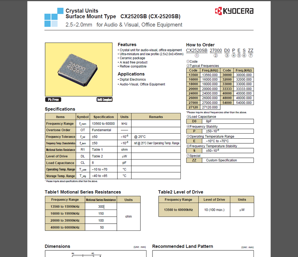

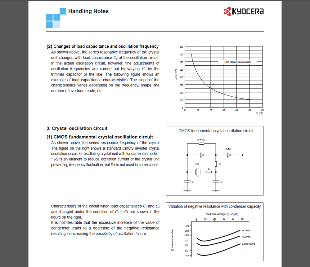

Kan_Li
Hi Kai Liu,
Sorry for the misunderstanding! What I mean is the data sheet provided by the vendor, it is something like the following:
You may find recommendation and ref schematics from that. Actaully if the crystal circuit introduces more jitter than USB spec, that would cause signal issue, so that the communication would be unstable.
Kan
