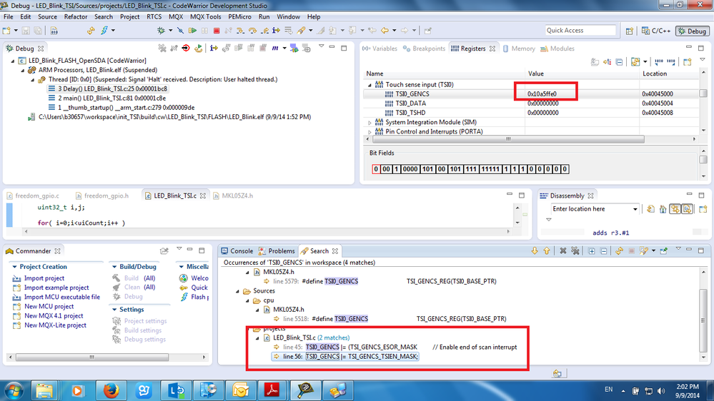

MichaelDavid
Hi Kan,
As you can see even from your screen shut, the Mode bits in GENCS (24-27) stays 0, the other bits can be changed. these bit always stays null.
BR,

Kan_Li
Hi Michael ,
I just got the feedback, please refer to the following for details.
There must be noise coupled to the TSI active channels and then TSI will signalize the noise level to 4bit number and return back to TSI_GENCS[MODE] for user to read. If TSI is working in a very peace environment the TSI_GENCS[MODE] will be read back as zero.
Hope that helps,
Kan
