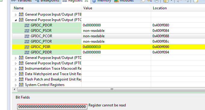

Hello Cmmunity,
I've configured a K20 GPIO pin (PTC4) as an input pin with the Kinetis Design Studio Driver BitIO.
Now it is possible to detect lows and highs on this pin. But after the High applied to this pin and left floating again the pin is on ~3V. The internal pull ups and downs are disabled.
Is this a normal behavior or can this near-high-level on a input pin after an attached high lvl be bypassed (without a pull down)?
4,830 Views
kerryzhou
Hi chris321,
  You test result is the same with me, this is the nomal behavior.
  If you want the input data is low, you can enable internal pull down register.
  Wish it helps you!
If you still have question, please contact me!
Jingjing

chris321
Hi Jingjing,
I am using the MK20DX256VLK10.
Here the register values from the GPIOC_PDIR for the 3 stages:
1. floating input/ or pulled to GND : 0x0
2. pulled up (via 10k) : 0x10
3. left floating again: 0x10
