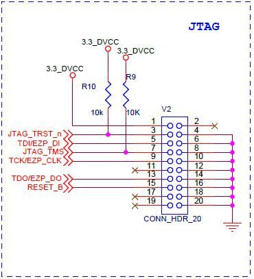

Hui_Ma
Please refer the <KQRUG> document chapter 2.1.5.3 about Kinetis debug interface.
The JTAG_TMS signal on PTA3 requires a strong pullup resistor for mode selection. The Cortex Debug specification
recommends that the JTAG_TCLK and JTAG_TDI pins (on PTA0 and PTA1) have pull resistors (high or low) to force a known state on these debug input pins.
Please check the K60 product solder processing, the peak solder temperature should below 260°C.
And please measure the RESET_b pin impedance with GND.
It will check if there with short connection of Reset pin with GND.
Wish it helps.
Ma Hui

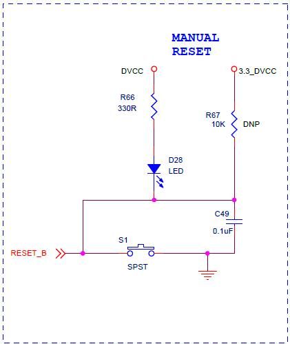

16,973 Views
anjum
Iam trying to program a custom made k60 board using mutilink jtag. Intialy for two three times it got programmed.But later it didnt get programmed. The reset_b and EZP_CS got low. So as said above i have added 10ohm resistor with a 47uF cap at the reset_b pin. Then the reset_b and ezp_cs pin got high. But still iam not being able to program it, I have pulled up the TDI pin also, the following error appears on kinetis studio
command line arguments: -device=K60FX512 -startserver -singlesession -serverport=7224 -interface=USBMULTILINK -speed=5000 -port=USB1 -USE_CYCLONEPRO_RELAYS=0 -FORCE_MASS_ERASE=0
Device selected is k60fx512
User Specified Hardware Selection : Interface=USBMULTILINK and Port=USB1
Connecting to target.
P&E Interface detected - Flash Version 9.33
Can not enter background mode  .
Unable to initialize PEDebug.
PE-ERROR: Failed to Initialize Target
Server running on 127.0.0.1:7224
Connection from "127.0.0.1" via 127.0.0.1
PE-ERROR: Target is not connected
Disconnected from "127.0.0.1" via 127.0.0.1
Target Disconnected.
The circuit of reset portion and jtag are attached.Please help.reset.JPGjtag.JPG

16,973 Views
Hui_Ma
It need to check /EZP_CS pin to make sure this pin keep high voltage during the reset phase.
While, I don't think that pin could affect Reset pin status.
Our TWR-K60N512 board using 0.1uF cap connect reset pin to ground.
You can remove 1nF cap to check if the reset pin could be pull up to high voltage.
If the reset pin still with low voltage, it need to check if there exists short connection issue.
Wish it helps.
