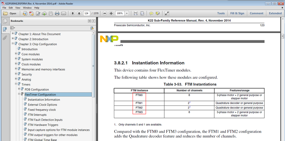

If you are using MK22FX512VLL12, it have four FTM modules. So I am not sure why you want to generate Tone frequency using GPIO instead of using FTM module.

markwyman
A PIT timer appears to be more optimized for internal peripheral timing, it doesn't appear to have a hardware connection to a I/O pin so you have to toggle a GPIO. Can you use a general purpose timer and PWM output instead? That way interrupt latency and other interrupt events in your processor wont get in the way of the pin toggling on time. What you are seeing now are other events blocking and delaying the pin from toggling.
