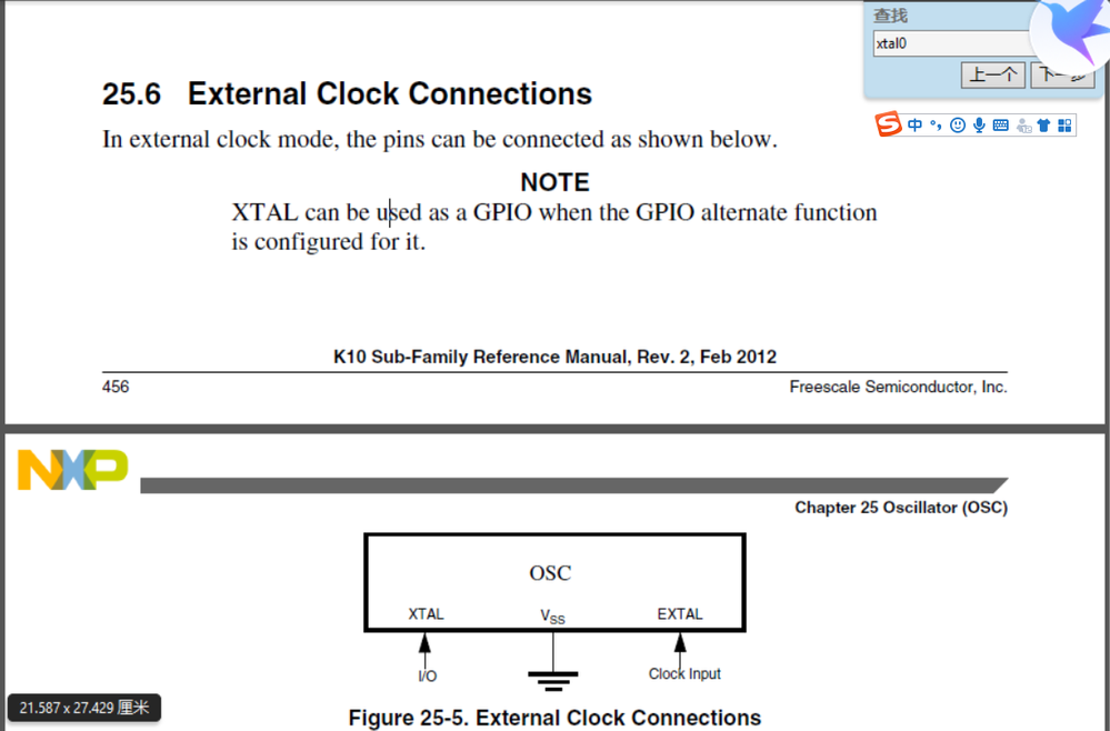

hi,all
      The MCU is MK10DX128VFM5, when I use the external clock and configure  PORTA->PCR[19]= PORT_PCR_MUX(1), this GPIO alternate function is configured GPIO(0x01),but this pin is still output clock signal。it can't output 1 or 0.
     when I use the internal clock, this pin can use as a GPIO.
     so I would know how to configure  PTA19 as a GPIO.

kerryzhou
Hi cheng dong,
  Do you debug the code, and check the PORTA_PCR19?
  Whether the MUX is really modified to 1 or not?

chengdong
Hi Kerry,
I confirm  MUX is really modified to 1.
I putout the value of this register(PORTA_PCR19),the value is 0x0100.
I can also configure PE and PS to 1, but this pin still can't work normally.

kerryzhou
Hi cheng dong,
  After you configure the PTA19 as GPIO pin, do you configure the GPIOA_PDDR |= 1<<19;? Just configure the PTA19 as output pin, then control the PDOR register to output the according data.
  If you don't set the direction register, after you configure the PTA19 as GPIO function, it will be the input pin.
Kerry

chengdong
Hi  kerry,
I think PTA19 is configured correctly,i has checked the correlative register.
now this pin output a 16M clock signal same as the external clock. when i switch to internal clock, this pin can work normally, so i think the problem is OSC and MCG.
thank you
cheng dong

kerryzhou
Hi cheng dong,
   OK, if you are using the external clock, when you debug your code, you will find this problem, the debugger will stop at the point which you swith the clock mode from FEI to FEE or PEE.
  Your problem is in the external clock configuration.
