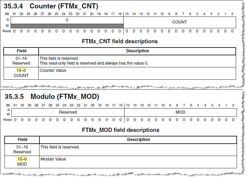

I was interested in knowing the PWM RESOLUTION (in time period) of the MKV10Z16VLC7 controller.
Please help with the same!

The PWM RESOLUTION is related to the MOD and counter frequency.
The FTM time reference is a 16-bit counter.
