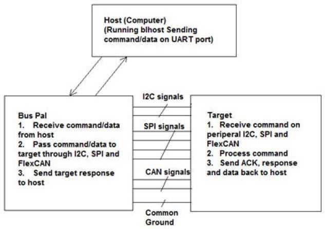

I'm trying to get bootloading going on a MK10DX64VLH7... the board does not have serial communication connected (it does have CAN and an EEPROM).
I want to be able to either communicate with a bootloader through CAN or pre-load my intended firmware upgrade onto an EEPROM and have the Bootloader process that. I've asked this before and gotten closer to the answer but still need some high-level guidance....
I looked into KBOOT and AN2295. It looks like KBOOT is more recent, but in looking at the supported processors it looks like K10 is not supported. I also tried downloading it and could not find a #define for a processor like it....
Key question: Does KBOOT support K10 processors? If not, can I leverage the flash update library from it or do I need another one? Could I use AN2295's flash library?

Hi Roger,
As you mentioned above, there're no serial interfaces on your board, however the AN2295 don't support any peripheral interfaces except the serial interface.
So AN2295 doesn't fit your design.
The Kboot provides the BusPal which act as a bus translator with an established connection with blhost over UART and with the target device over I2C, SPI, or CAN, and assist blhost in carrying out commands and responses from the target device.
The Fig 1 below illustrates the role BusPal plays in blhost communication with the target device.
The Kboot 1.2 doesn't support the MK10 now, however you can follow the steps in the Chapter 10 Kinetis bootloader porting section in the Kboot reference manual.
I've also attached the document.
