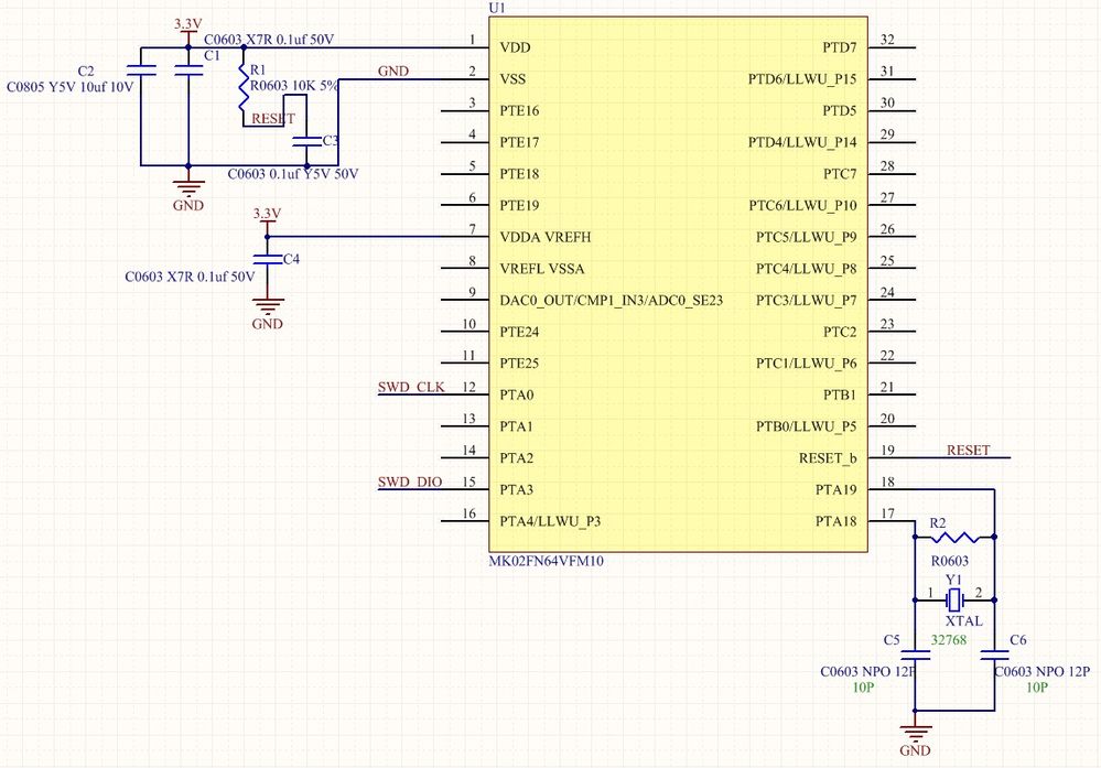

When i enter vlls3 mode , i  measure power comsumption  2xx uA (i use external osc 32768hz),
Where am i setting wrong?
IC:  MK02FN64VFM10
Environment: IAR 7,3
My code:

Electric circuit:

    Before you enter in the VLLSx, you can change your clock mode to BLPI, and disable the OSC module, because OSC module also have large power consumption:
  Besides this, where the current point you are measuring your power consumption, did this point just contain the MCU power consumption, no other external circuit power consumption?

Hi Jinjing,
    1.  I have tried to change to BLPE then into VLLS MODE, but get the same current consumption .
         OSC Module in low-power mode power consumption is 500nA, but I measured the amount is too much difference .
    2.  Yes, no other external circuitry. I would like to test the power consumption , so do not add any circuit
Thank you.

herol
Dear Jingjing,
     It's good,  the power consumption is about 2uA.
     This indicates that "SMC_PMPROT = SMC_PMPROT_AVLLS_MASK"  is invalid . Is that so?
Thanks.

kerryzhou
Hi herol,
          From the reference manual:
       You can find that SMC_PMPROT regisster is the write once register after any system reset, because after reset, SMC_PMPROT is defined as 0 in PE code, then although you define it again in your main function, but it is invalid, you can't enter VLLSx mode because AVLLS is not enabled, at this time, the MCU enter stop mode, that's why you get about 200uA.
      If SMC_PMPROT is defined as 0XAA after mcu reset, then all the low power mode is enabled, the according low power will enter successfully.
