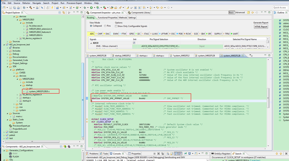

Hi herol,
    Sorry for my later reply, I already find the root problem.
    Please do the modification like the following picture:
Just modify the
#define SYSTEM_SMC_PMPROT_VALUE 0x00U
to
#define SYSTEM_SMC_PMPROT_VALUE    0xAAU
You can find this defination in system_MK02F128.h, the path is: project path->SDK->device->mk02f12810->startup folder.
Then add the ENTER_VLLS3 code,  after you download the code to your chip, unconnect your debugger, repower on your board, you will find the power consumption is about 2uA.
Wish it helps you!
If you still have question, please let me know!
Jingjing
