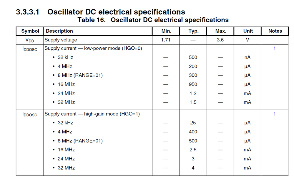

    Before you enter in the VLLSx, you can change your clock mode to BLPI, and disable the OSC module, because OSC module also have large power consumption:
  Besides this, where the current point you are measuring your power consumption, did this point just contain the MCU power consumption, no other external circuit power consumption?

herol
Hi Jinjing,
    1.  I have tried to change to BLPE then into VLLS MODE, but get the same current consumption .
         OSC Module in low-power mode power consumption is 500nA, but I measured the amount is too much difference .
    2.  Yes, no other external circuitry. I would like to test the power consumption , so do not add any circuit
Thank you.

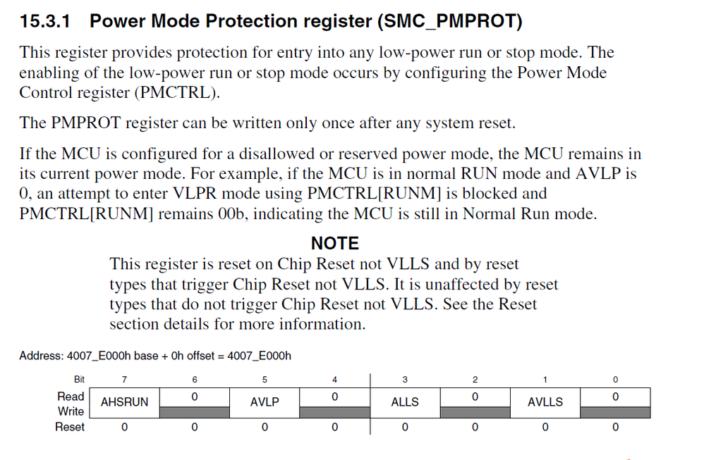

herol
Dear Jingjing,
     It's good,  the power consumption is about 2uA.
     This indicates that "SMC_PMPROT = SMC_PMPROT_AVLLS_MASK"  is invalid . Is that so?
Thanks.

kerryzhou
Hi herol,
          From the reference manual:
       You can find that SMC_PMPROT regisster is the write once register after any system reset, because after reset, SMC_PMPROT is defined as 0 in PE code, then although you define it again in your main function, but it is invalid, you can't enter VLLSx mode because AVLLS is not enabled, at this time, the MCU enter stop mode, that's why you get about 200uA.
      If SMC_PMPROT is defined as 0XAA after mcu reset, then all the low power mode is enabled, the according low power will enter successfully.
Wish it helps you!
Jingjing

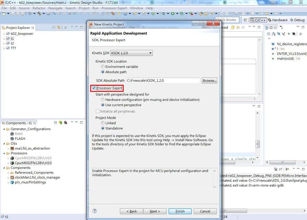

herol
Hi Jingjing,
     I use your KDS project 、 remove debug tool and repower to get power consumption 3.7uA.
     If I creat new Processor Expert project (using the same code)、 remove debug tool and  repower to get power consumption is 2XXuA.
     I have a question , how to creat  a no Processor Expert projcet for IAR or how to reduce power consumption in a
     Processor Expert projcet ?
Thanks.
herol
9,145 Views
kerryzhou
Hi herol,
Could you tell me the PE project which still have 2xxuA with what IDE?  KDS  PE project or just use Processor expert for IAR project with out KDS?
Jingjing
9,145 Views

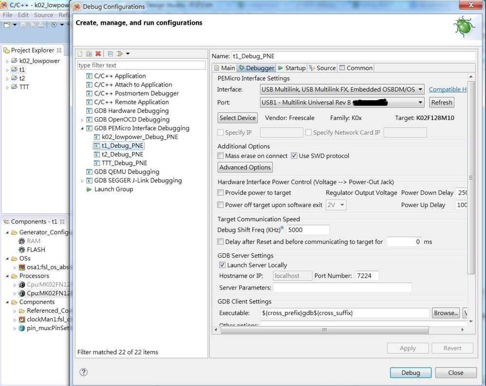

herol
Hi Jingjing,
     I use PEMICRO MULTILINK UNIVERSAL.
     I creat a project and select Processor Expert  the power consumption is 2xxuA.(KDS 3.0)
     I creat a project and no choose Processor Expert  the power consumption is 3.7uA.(KDS 3.0)

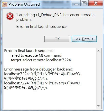

     But now I do not know which option to set the resulting PE project enters debug mode will have an error message.
Thanks.
herol
9,145 Views
kerryzhou
After you build the PE project, any error in the problems window?
You should make sure no error before downloading.
Besides, if still not ok, you can try to create a new PE project, and download the code again.
9,145 Views

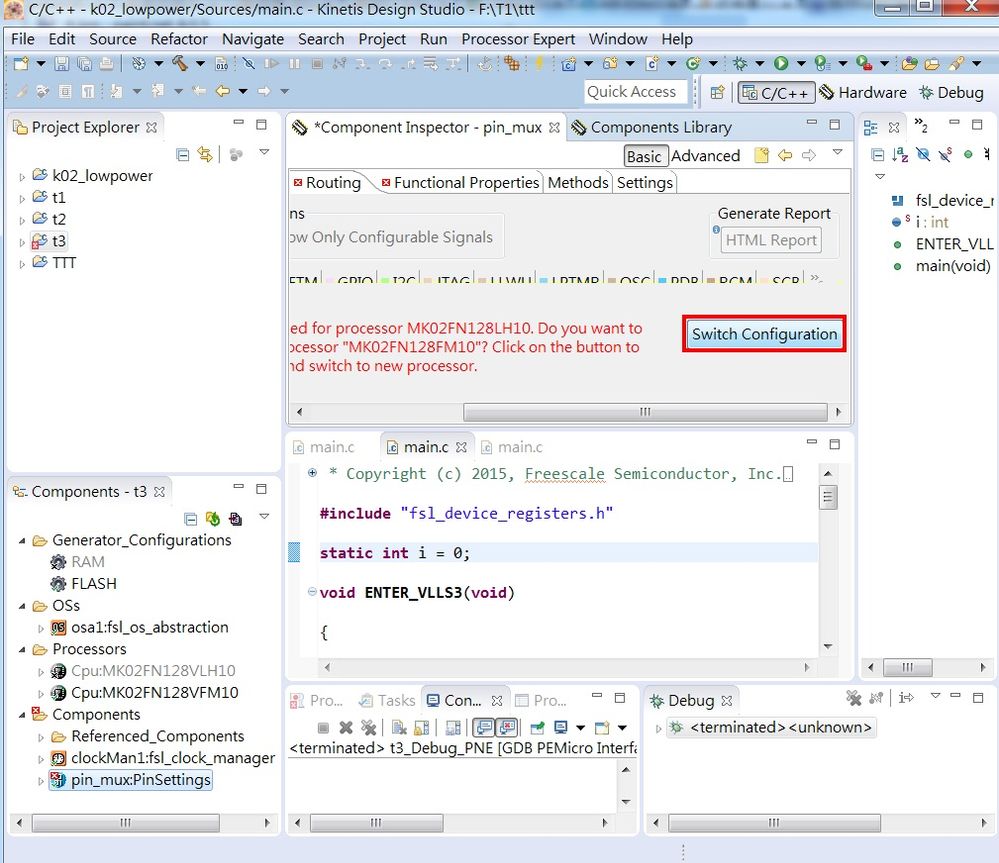

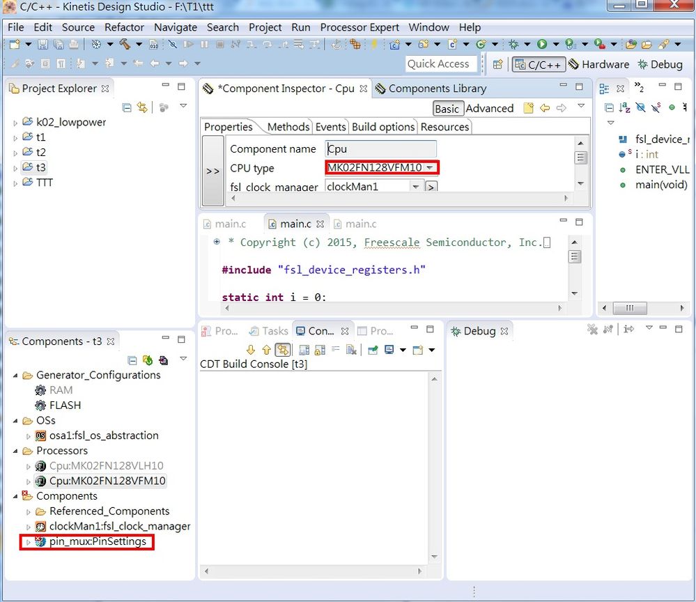

herol
When I change the cpu type pinmuxs have a error, then to click switch configuration can be solved , in addition there is no other error message.
