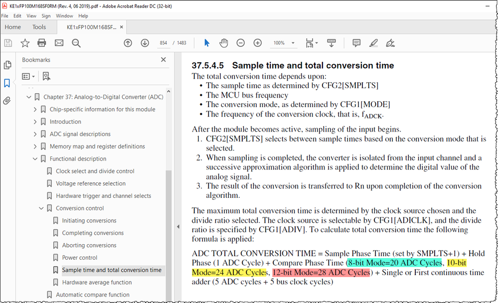

Hi.
I'm using the MKE14F.
In ADC, I can choose conversion mode about  8, 10, or 12 bits.
So, if I choose the 8bit conversion mode, it is the more fast conversion than 12bit mode?
Or, are there same conversion time about 8, 10, 12bits?
Please tell me.
Thank you very much.
2,455件の閲覧回数
Robin_Shen
Yes. Please read the "37.5.4.5 Sample time and total conversion time" of KE1XFP100M168SF0RM.
37.5.4.5 Sample time and total conversion time.png37.5.4.5 Sample time and total conversion time.png
Robin

rs__zen
Dear Robin
Thank you for your answer.
I'll read this section.
