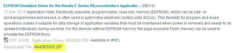

You may take a look to the application note "AN4903 EEPROM Emulation Driver for the Kinetis E Series Microcontrollers":
http://cache.freescale.com/files/microcontrollers/doc/app_note/AN4903.pdf
The appnote comes with a software package. To download it run a search in Freescale webpage for AN4903 and you will find it as a ZIP file:

Hi Jorge,
I want to use the flash as an EEPROM with MKE04 and I am interested in AN4903SW driver, which I can't found it. Please, can you send me the dowload link or zip?
Thanks.
Joaquim.
