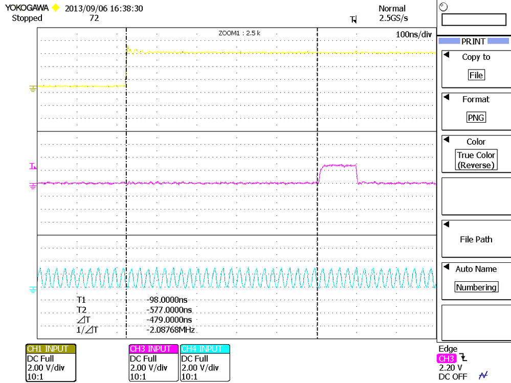

But, I'm observing a different behaviour. It is possible to check the wave below:
TRACE 1: the edge that generaete the interrupt  (port E pin 0)
TRACE 2: a pin asserted immediately when ISR is started and deasserted at the end of ISR (port A pin 17)
TRACE 3: the TRACE_CLKOUT pin with system clock/2.

Fabio, your test is not measuring the interrupt latency. It is measuring the time from the application of the interrupt to the GPIO going high. You are forgetting to count the cycles generated by the entry overhead of the C ISR function and subsequent C bit setting statements.
There will be cycles used in the set up of the C interrupt function frame. There are at least 3 cycles used for PORTE_ISFR |= 0x01. One cycle to read PortE_ISFR to a register,  one cycle to OR 0x01 into the register and a write of the register to PortE_ISFR. There are at least three cycles consumed in the setting of the output  PIN. Notice how many cycles it takes for the signal to go from high to low with back to back C GPIO write statements in your example.
You need to look at the assembly code of the Interrupt function to find out how many cycles are being consumed before you set the GPIO pin. You need to subtract the cycles the C function used to get an accurate read of interrupt latency.
Norm

FabioPacio
Dear all,
thank you for the clarification, but i'm not underdtandig what is appening:
The instruction if ISR are:
0x00000000                PORTE_INT_HANDLER:                                 cycles
0x00000000  0x01A0F24D             movw               r1,#53408               1
0x00000004  0x0104F2C4             movt                 r1,#16388               1
0x00000008  0x6808                      ldr                     r0,[r1,#0]                2
0x0000000A  0x0001F040             orr                     r0,r0,#1                  1
0x0000000E  0x6008                      str                    r0,[r1,#0]                 2
0x00000010  0x010CF24F             movw               r1,#61452               1
0x00000014  0x010FF2C4             movt                r1,#16399               1
0x00000018 0x6808                       ldr                     r0,[r1,#0]                 2
0x0000001A  0x3000F440             orr                    r0,r0,#131072           1
0x0000001E  0x6008                     str                     r0,[r1,#0]                   2     tot= 14
0x00000020  0x010CF24F             movw               r1,#61452
0x00000024  0x010FF2C4             movt                r1,#16399
0x00000028  0x6808                      ldr                    r0,[r1,#0]
0x0000002A  0x3000F440             orr                    r0,r0,#131072
0x0000002E  0x6008                      str                   r0,[r1,#0]
0x00000030  0x4770                      bx                    lr
And if these calculations are right:
SYSTEM CLOCK 96,0E+6Hz    --> T_CYCLE 10,4E-9 Sec
DELAYS                                                   CYCLES                     TIME (sec)
INTERRUPT LATECY                                  12             -->          125,0E-9
ISR INSTRUCTIONS EXECUTION               14            -->           145,8E-9
FLASH WAIT STATE@24MHz                                                    41,7E-9
  TOTAL 312,5E-9
Why I'm measuring a delay of 420ns instead of 312?
  1. CH1 --> PTE0  interrupt enabled on falling edge.
  2. CH3 --> PTA17 toggle of pin done inside the ISR
  3. CH4 --> TRACE_CLKOUT
  Where is my mistake? can someone help me?
Thank you
Fabio
7,136 Views
philip_drake
Hello Fabio,
When you are counting clock cycles in your code sequence you are only considering the time the core takes to execute the instruction.
In the MCU a write to a GPIO register traverses a Cross-bar switch and then a bus gasket and then it gets to the peripheral.  If you assume best case being the core is not in contention on the crossbar for the GPIO slave bus( a good guess in this case) then the number of cycles through the cross bar is 1-2 cycles.
The number of clock cycles through the peripheral gasket into the peripheral is another 1-2 cycles.  After the write completes in the core the actual write to the register could be 4 plus cycles later.  The entire operation is going to take not 2 cycles but 6 cycles.
If you do a read from a peripheral the core is stalled for the 2-4 cycles while the read comes back with the result.  Core execution may need to wait longer if the peripheral is in a different power domain.  Peripherals like the LLWU, LPTMR, RTC, CMP, TSI are in a seperate power domain and syncronization between domains add addition cycles.
So that is why you are measuring 420 ns actually instead of the theoretical of 312.  Because the theoretical is no accounting for the amount of time the core is waiting on the MCU read and writes to complete to the peripherals.  The serialization of events in an embedded system is complicated by the inconsistency of the timing in the MCU.  Add more complication if the core is not the only master on the cross-bar.  The DMA could be enabled and could be arbitrating for the slave bus on the cross-bar, increasing the time the core is stalled awaiting the bus to be freed from the DMA.
I hope this helps.

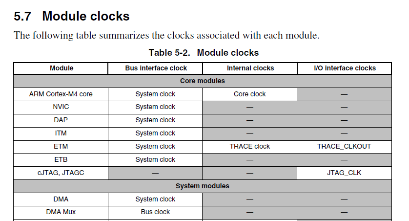

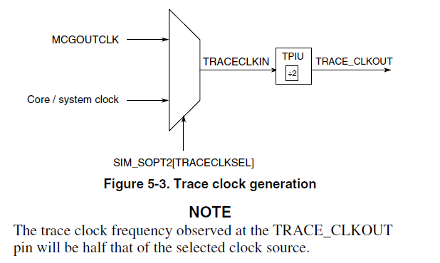

In the last trace, the signal you see is the core clk which is the maximum speed while the NVIC module runs at the bus clk frequency [half the core speed], This is the reason you are observing 24 clk cycles between the interruption trigger and the interruption response.
7,136 Views
FabioPacio
Dear Andrea,
the last trace is the TRACE_CLKOUT, it is the half of clock source. As you can see here.
And the NVIC run at System clock not at Bus clock...
There is someone that can help me to undertand why the latency is too big than 12 cycles?
