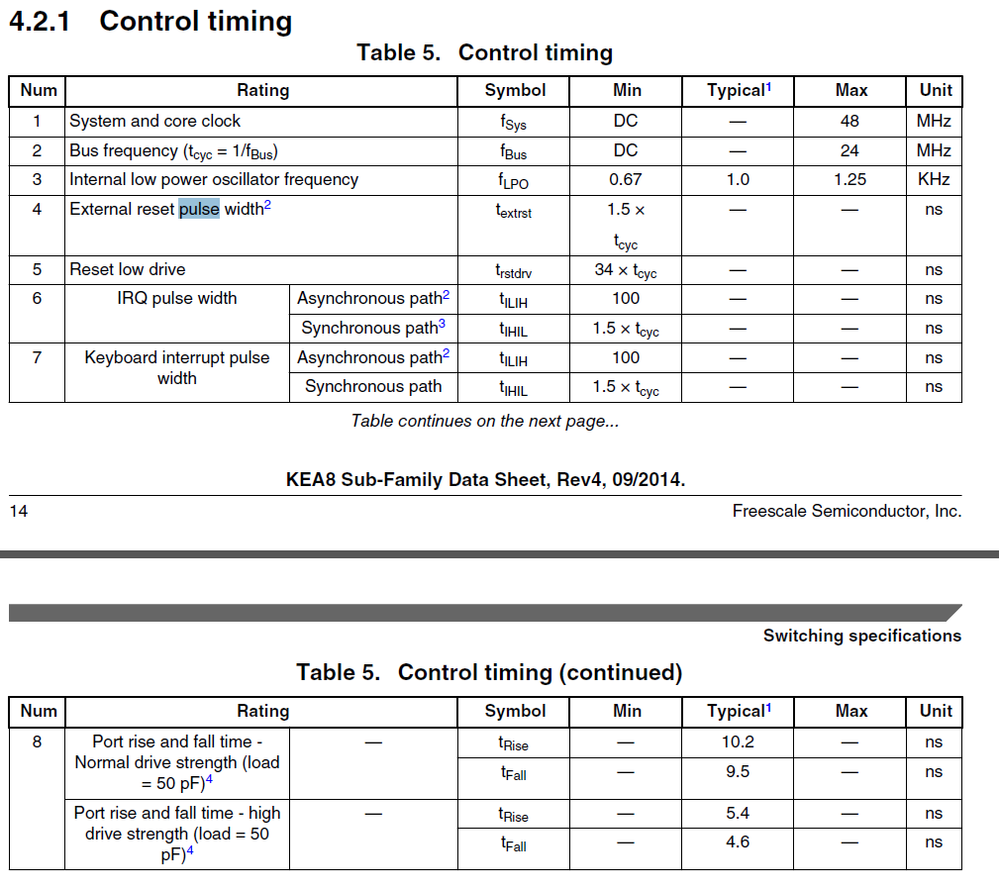

     I have certain Doubts in Edge AND Level Triggered Interrupts.
1)  How Edge and Level Triggered Interrupts in KEA-128 are asserted?
2) What is the Interrupt assertion time for Edge Triggered Interrupts?
3)What is the Interrupt assertion time for Level Triggered Interrupts?
Please provide answers for the above questions with Numerical values and documentation :smileyhappy:.

Hi, Vignesh,
Regarding the interrupt assertion time of GPIO pin interrupt and keyboard interrupt, pls refer to the table, which I copied from data sheet of KEA128.:
Hope it can help you
