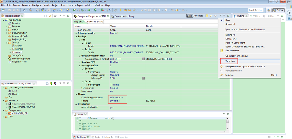

kerryzhou
Hi Kirti Raje,
    If you want to change the bit rate in the CAN_LDD, you can change it in bit rate item:
  About the register for bit rate, it is CANx_CTRL1. More details, you can refer to the reference manual for K64, chapter 49.4.8.4 Protocol timing.
Wish it helps you!
