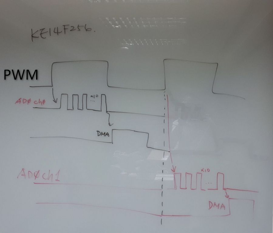

Hi Support team,
  Our customer hopes to use two channels of ADC with DMA, and the two ADC+DMA interleave. The ADC is triggered
by a PWM which is used to energize a coil. Please refer the illustration below.
  Because can't find a similar use case in our application notes or example code, need your support to suggest a solution and nice to have a workable sample code. Thanks a lot.

Hi StanleyH,
I think the method to solve this question as below,
  1. The LPIT is configured as periodic counter which will output pre-trigger and trigger signal to TRGMUX periodically.
  2. the ADC is triggered by TRGMUX .
  3. configure DMA channel to get the ADC conversion result .
