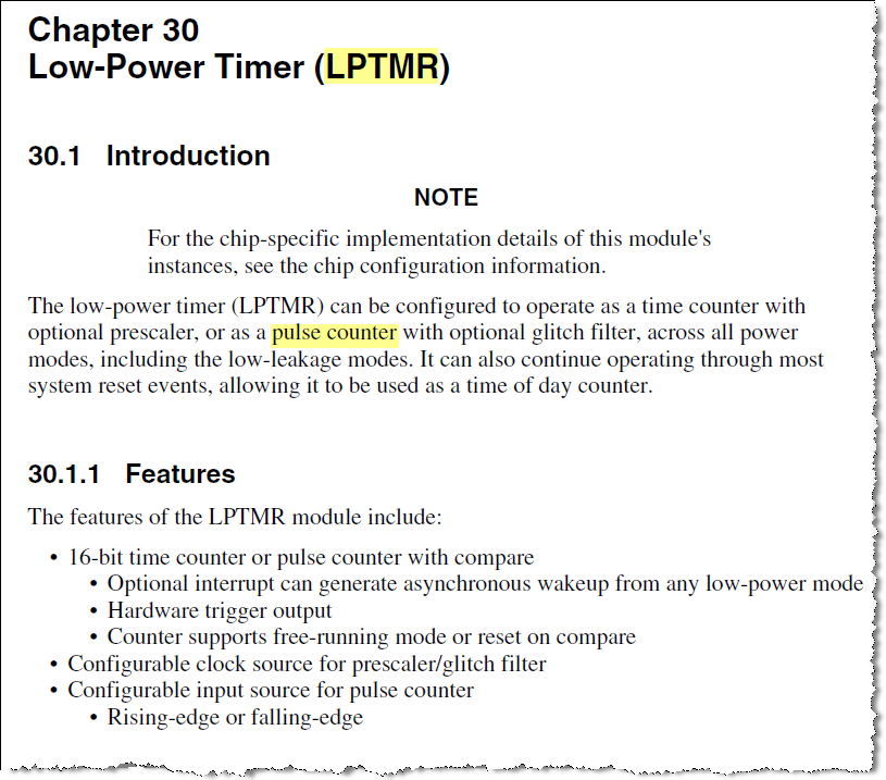

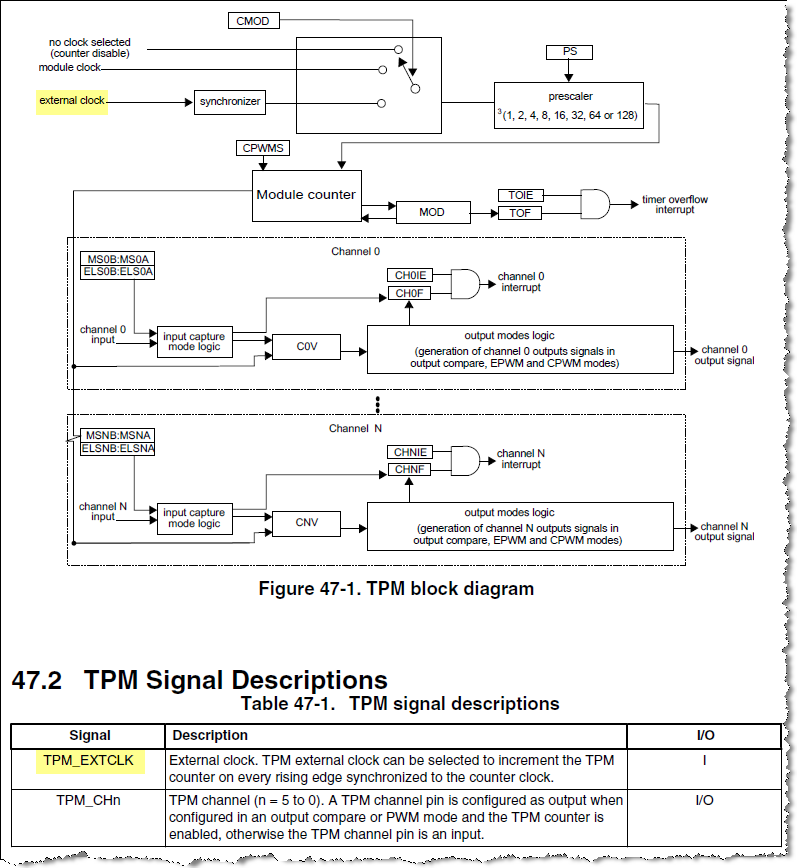

Robin_Shen
Hi MI,
I am not sure if you can accept the use of the LPTMR module as a pulse counter.
If TPM module is must, then select External Clock as TPM clock source.
Robin
