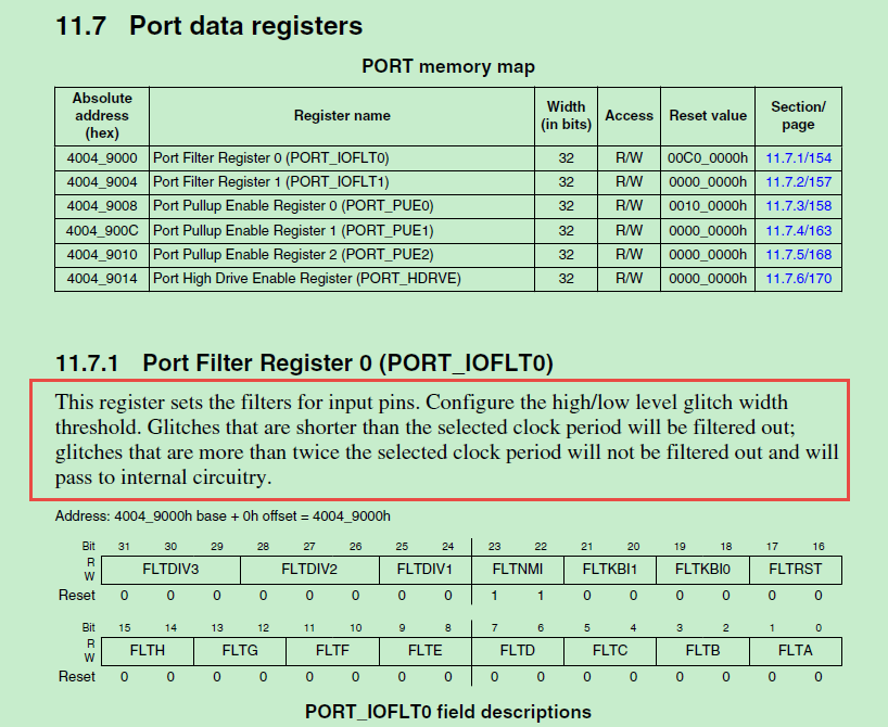

   About the KEA128 input glitch filter normally is defined in the PORT_IOFLT0 and PORT_IOFLT1 register.
  More details, actually, you can find it in the reference manual:
  If you defined the port glitches filter, then if the input wave have the small small glitches which is shorter than the defined time, that glitches will be ignored. this usage is useful to reduce the input interference.

  Did you checked the reference manual, PORT_IOFLT0 and PORT_IOFLT1 register which I have shown you in the last reply?
  Please read the reference manual carefully at first, thank you!
  From the register description, take PTA as an example, you will get the min time is BUSCLK, the max time is BUSCLK/4096.

                       According to your reply, If the min time is Bus clock say example 24 Mhz.
Then min time would be 1/24 Mhz = 41.6 ns.
Max time is BUSCLK/4096 = 41.6 ns / 4096 = 10.15 ps, which is lower than min time.
And in Datasheet it is been given that Glitch filtering time is 2 * selected time, say 2 * BUSCLK time(based on down-up-down or up-down-up counting) but you are saying that it is max BUSCLK freq only.
Since there is very little information provided on datasheet, Can you please help me in understaing it and in calculations of min and max time?
